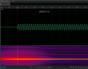

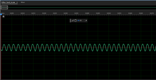

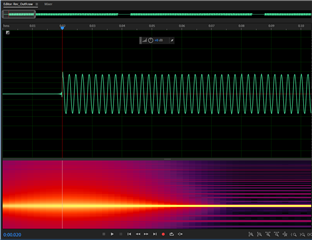

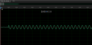

  • Hi Jianzhong,
    Thanks for your response.
    We do the measurements as your guide:
    1.keep NE silent, and set  aer_ctl.modes_0.value to 0x82 to disable AER. when dial tone is being received, the NE output level is -27dbm0.
    2. set ctl.modes_0 to 0x83 to enable AER and disable NLP. when dial tone is being received, the NE output level is almost the same: -27dbm0.
    3. set ctl.modes_0 to 0x87 to enable AER and NLP, when dial tone is being received, the NE output level is -41dbm0.
    It seem the adaptive filter is not converged.

  • Hi Dudechao,
    In your latest capture, your recv_out and send_in both have the tone starting at 0:00:020. There is no delay between recv_out and send_in.
    Let me try to explain.
    • The recv_out from aerReceiveIn() processing goes to your speaker.
    • Then the sound travels through your enclosure and the air and arrives at the mic, and becomes send_in signal. This is the echo.
    • At the same time, you provide recv_out to aerSendIn() as the reference signal, which is referred as recv_out_sync. You probably have some buffering delay between recv_out and recv_out_sync.
    • There should be delay between recv_out_sync and send_in, i.e. reference signal should arrive before echo. Otherwise, your system is not causal and it will never converge.
    • Assuming there is no buffering delay between recv_out and recv_out_sync, send_in should always be a delayed and distorted version of recv_out_sync, because echo cannot come earlier than the original signal.
    • Parameter y2x_delay is used by the adaptive filter to insert delay to recv_out_sync to optimize convergence in case the echo path has long delay.
    So in your case, you should set y2x_delay to 0. More importantly, you need to examine your system and figure out why there is no delay between your send_in and recv_out_sync. Just to confirm, you dumped out the two signals that are provided to aerSendIn(), right?
    Thanks and regards,
    Jianzhong

    I looked at your captures: IsItConvergenced.rar. There is about 1.2 msec delay between send_in and recv_out. The send_out signal shows some kind of convergence. That is encouraging. The reason why max_canc_l2 is 0 could be that AER detects tone and resets itself. AER has tone detection which works as the following:
    1. if AER has already converged and detects tone from FE, AER will slow down adaptive filter update to preserve the coefficients. When tone disappears, AER will go back to normal filter update.
    2. if AER has not yet converged and detects tone from FE, AER will reset itself when tone disappears.
    Can you perform same test but sending CSS or pink noise from FE before sending the dial tone? I hope to see convergence similar to Figure 5 of the tuning guide. You can set y2x_delay to 0.
    Jianzhong
