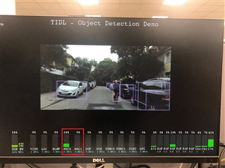

We have one TDA4VM customer board,
Recently we try the vx_app_tidl_od.out on our customer board,
and we find there is one issue that our MSC1 always run 0%, like below picture
and compare the vision_apps document, the MSC1 should have 9% usage-rate.
After this, I try to modify the app_create_graph_img_mosaic in psdkra/vision_apps/modules/src/app_img_mosaic_module.c, like below

But after this modify on our customer board, I still see the MSC0 have value, MSC1 still null.
So I have some questions:
1. Do the MSC1 didn't run is normal when we run the vx_app_tidl_od.out demo?
2. As my modify, does the TIVX_TARGET_VPAC_MSC2 just mean the MSC1?
    or does I miss some code that need to modify for MSC1?  so I can't see the MSC1 run.
Can someone help to answer?
  • The Mosaic node by default uses both MSC0 and MSC1 to perform the required task. This is set by calling the tivxImgMosaicParamsSetDefaults() function in the app's respective main.c. However you can override this default and assign just one MSC to Mosaic Node.

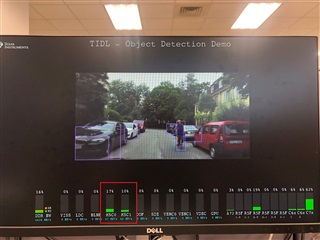

  • Hi Shyam:
    Thanks your information,
    after I try to modify the num_msc_instances / msc_instance in tivxImgMosaicParamsSetDefaults()  as below
    diff --git a/kernels/img_proc/host/tivx_img_mosaic_host.c b/kernels/img_proc/host/tivx_img_mosaic_host.c
    index 350aef4..61fc599 100644
    --- a/kernels/img_proc/host/tivx_img_mosaic_host.c
    +++ b/kernels/img_proc/host/tivx_img_mosaic_host.c
    @@ -225,6 +225,6 @@ void tivxImgMosaicParamsSetDefaults(tivxImgMosaicParams *prms)
         memset(prms, 0, sizeof(tivxImgMosaicParams));
         prms->enable_overlay    = 0;
    -    prms->num_msc_instances = 2;
    -    prms->msc_instance      = 0;
    +    prms->num_msc_instances = 1;
    +    prms->msc_instance      = 1;
    Now I can see the MSC1 run about 10% usage-rate.

  • In the default mode, since both MSC instances are used the performance logger reports the loading only for one MSC instance. Ill file a bug and follow up on the fix if possible. Thanks for pointing out.
