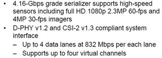

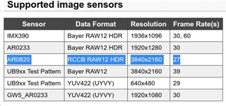

I have a question about the AR0820 27 FPS limitation on EVM board,
Because our colleague find form AR0820at
Fast Full Resolution Video Capture of 3840 x 2160 at up to 40 fps in 3−exposure HDR and 30 fps in 4−exposure HDR
And the FPD-LinkIII and DS90UB960's CSITX speed all should support the 3840 x 2160 resolution on 30fps.
Are there any bottleneck to effect the AR0820 only can support to 27fps?
