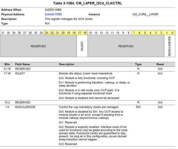

  • Hi Stanley,
    Can you please tell me from where we can enable the I2C4 clock. From TDA2PX TRM I2C4 clock is already enabled.
    Deepika
  • Typically, it should be enabled by Linux already.
    You can double check this by reading the below register. It should be 0x2.
