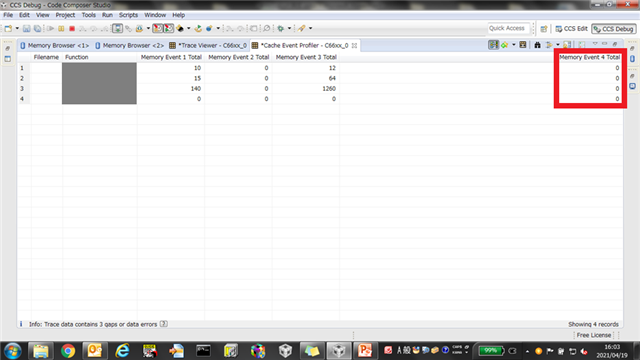

The customer has two questions about cache trace on C66x. They’re now trying to measure the cache hit ratio.
They’re trying Trace feature of CCS with XDS200. It seems to be able to count the number of cache misses in a given time, but it seems not to be able to count the number of cache hit.

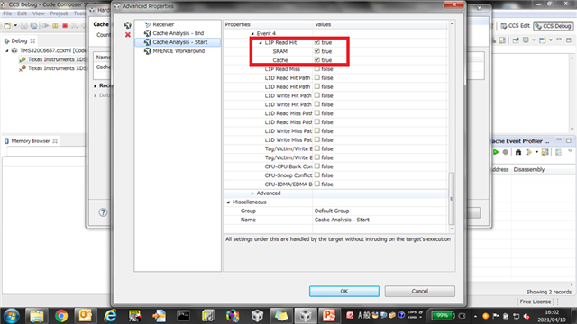

They selected Advanced Setting on the screen of Hardware Trace Analysis Configuration and added L1P Read Hit to Event 4, but Event 4 was not counted on Cache Event Profiler.
Is there any way to count the number of cache hit or the cache hit ratio ?

  • Hideaki-san,
    I believe I can reproduce this behavior, or at least something similar. I believe it occurs when trying to collect L1P Read Hit for Event 4. But if L1P Read Hit is configured for another event (like Event 1), I am able to see the data. Can the customer check to see if this is the case for them also?

  • I believe this is possible. You can set trace control points to also control when to start and end trace. However, I don't see an easy way to view the data once captured. I will need to follow up with the engineers.
    I believe you can set this up in the advanced properties instead and use the action to Start Trace and specify the address to start on. Then you can add another trigger to end trace at the other desired address:
