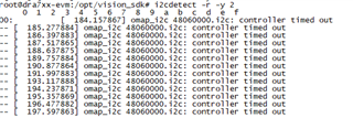

Hi
The client bought EVM5777G-03-40-00, FPD Link, and the client bought SDI Part #: 703767-0001 (Contents of Themultides Surround View Kit), as attached.
However, the EVM5777G cannot communicate with the camera and the camera information cannot be displayed.
Camera is OV10635. It is not normal to access i2c2 using i2C tools on Linux.
What could be the reason?Hardware and software compatibility issues?thanks!
The printed information is as follows:

 [HOST] [IPU2  ]     51.721374 s: src/bsp_deviceI2c.c @ Line 386:
 [HOST] [IPU2  ]     51.721496 s:  I2C1: DEV 0x76: RD 0x01 ... ERROR !!!
 [HOST] [IPU2  ]     51.721588 s: src/bsp_deviceI2c.c @ Line 412:
 [HOST] [IPU2  ]     51.721710 s:  I2C1: Error timeout 659 ms!!!
 [HOST] [IPU2  ]     51.721801 s: src/bsputils_lvds.c @ Line 919:
 [HOST] [IPU2  ]     51.721862 s:  device address - 76 i2c error - -21
 [HOST] [IPU2  ]     52.386201 s: src/bsp_deviceI2c.c @ Line 765:
 [HOST] [IPU2  ]     52.386292 s:  I2C1: DEV 0x3a: RD 0x300a ... ERROR !!!
 [HOST] [IPU2  ]     52.386384 s: src/bsp_deviceI2c.c @ Line 836:
 [HOST] [IPU2  ]     52.386475 s:  I2C1: Error timeout 660 ms!!!
 [HOST] [IPU2  ]     52.387329 s:  VIDEO_SENSOR: INST4 : I2C1 : I2C Addr = 0x3b
 [HOST] [IPU2  ]     52.709998 s:  VIDEO_SENSOR: VIP 8: DRV ID 1205 (I2C ADDR 0x3b): a635:0000:7fa2
