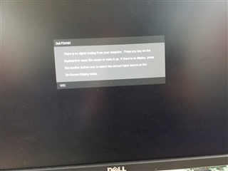

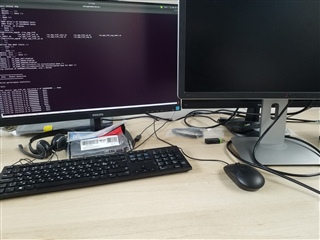

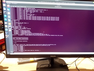

Hi TI,
After migration from SDK 7.1 to 7.3 and successful built Linux+RTOS we found that there is no display output for run_app_tidl_oc and other executable files. Monitor cannot see
To connect EVM with Monitor we use DisplayPort-to-HDMI Adapter.
1) Is it possible to capture display output somehow and redirect it to Monitor with HDMI input?
From RTOS Docs (SDK7.3) in section "5. EVM Setup for J721E" (ti-processor-sdk-rtos-j721e-evm-07_03_00_07/psdk_rtos/docs/user_guide/evm_setup_j721e.html), we found that "DisplayPort-to-DVI or DisplayPort-to-HDMI adapters don’t work with DisplayPort"
2) Is it possible in future releases to connect EVM to Monitor via DisplayPort-to-HDMI Adapter?
3) Is it possible to redirect Display0 output to file?
An output log from EVM tda4vm attached below.
