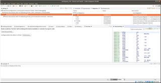

  • Hi Bin,
    - If the JTAG header is available on your board, connect an emulator, and halt the CPU while the delay happens and check where it got stuck in the code. If you can load the kernel symbol files with kernel debug info enable, you could see where the the PC stops in the kernel source code.
    I tried to do this using two different debuggers: XDS110 and Jlink Ultra+.
    To be able to debug Kernal, I added flags according to this thread:
    e2e.ti.com/.../cortxa8-error-connecting-to-the-target-error--1204-0x3d5b-unable-to-access-the-dap
    I can connect the debugger and walk through the code...
    Unfortunately, once I invoke the
    rtcwake -m standby -s 5
    I get the following error:
    On XDS110
    CortxA8: Error: (Error -1170 @ 0x0) Unable to access the DAP. Reset the device, and retry the operation. If error persists, confirm configuration, power-cycle the board, and/or try more reliable JTAG settings (e.g. lower TCLK). (Emulation package 9.3.0.00032)
    On Jlink
    CortxA8: Error: Stat [ JLINKARM_IsHalted() call ] failed!
    CortxA8: Trouble Halting Target CPU: Halt failed!
    Do I miss anything? How exactly do I need to attach a debugger to see where the code is stuck?
    I wonder if it is possible, to debug "through" the standby state. After calling rtcwake, JTAG disconnects.
    Adam

  • Hi Adam,
    Once you connected to M3, can you halt M3 then check its PC location, and de-assembly the code to tell where it is?
    You might also want to quickly resume and halt M3 multiple times to see if the PC stuck in M3?
  • Hi Bin,
    It moves between 0x235A and 0x235C
    Moreover, I found that this extra delay only happens on the first rtcwake invocation after the board reset.
    Below I enclose some numbers for the first and subsequent invocations.
    First invocation after reset (rtcwake -m standby -s 5)
    First try - 18s
    Second try - 29s
    Subsequent invocations
    First try - 5s
    Second try - 5s
    Adam
  • Hi Adam,
    The info is helpful.
    I will look into it and get you back.
