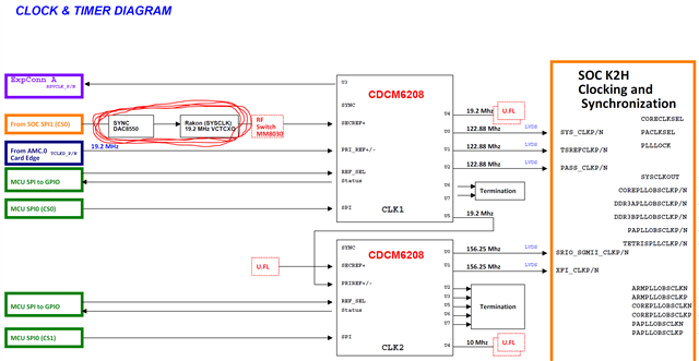

I'm using XTCIEVMK2X ver4.0 board and trying to do some experiments with PTP. I have PTPd successfully using my device driver that implements hardware time stamping (with CPTS module). Some functionality that I'm missing is adjust frequency capability. In a Keystone 2 "Time Synchronization" power point, there's mention that I should be able to do this by writing to DAC over SPI. I was hoping for more information about this (I'm not seeing anything about VCX0, DAC, or SPI in Keystone PLL user's guide). Also is there anywhere I could get reference driver and/or DPLL SW that's alluded to in that power point?
  • From schematic I see the following from SPI getting fed to DAC->VCTCXO which I'm guessing is what the power point was referring to:
    I'm still a bit confused as to what addresses, registers, etc. to do what I'd like. Right now I'm using the default RFTCLK set to SYSCLK2 so any help on how to appropriately adjust the frequency would be greatly appreciated.
