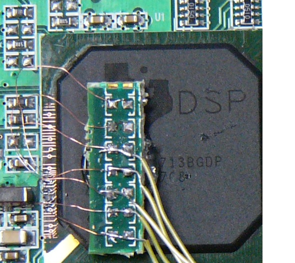

  • Greetings,
    Even with the BGA package, one can get lucky in finding the trace/via for the HOLD on the FR4 package carrier (to side of the BGA), and apply such an experiment.  I had to do that in my previous life on the C6713, see attached pic.
    Good Luck,
    Sam

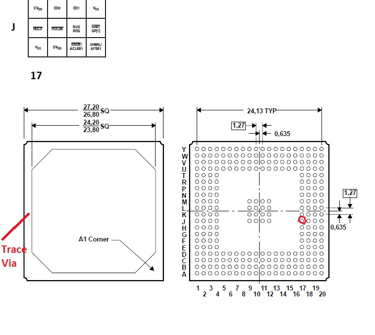

  • Greetings,
    From the C6713 Datasheet and the pic below
    You can use a bare part, shave off the green epoxy, ohm out the J17 ball to the facial trace/via and then realize your PU/PD on a part on one of your platforms.
    Good Luck,
    Sam
  • Greetings,
    You may not need to do this exercise, since the HOLD pin has an IPU enabled, according to the device DS.
    Good Luck,
