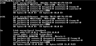

One of my AM64x EVMs is intermittent about connecting to ethernet under Linux. This is my newer EVM, so it's surprising it has problems.
I've tried the following linux images that either came on a board I have or were part of the 7.3 SDK. with mixed success on all of them: This is the output of uname-a:
  • Linux am6x-evm 5.4.77-g898983c424 #1 SMP PREEMPT Tue Dec 15 23:37:17 UTC 2020 aarch64 GNU/Linux (came with one board)
  • Linux am64xx-evm 5.4.87-gb6adce5bd1 #1 SMP PREEMPT Wed Jan 27 04:55:50 UTC 2021 aarch64 GNU/Linux (came with one board)
  • Linux am64xx-evm 5.4.106-g023faefa70 #1 SMP PREEMPT Mon Apr 12 14:19:22 UTC 2021 aarch64 aarch64 aarch64 GNU/Linux (image from PSDK)
What troubleshooting steps would you recommend?

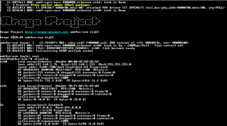

  • Hi Schuyler,
    Using the 7.3 RT binary which I've moved to (Linux am64xx-evm 5.4.106-rt54-g519667b0d8 #1 SMP PREEMPT_RT Tue Apr 13 04:03:24 UTC 2021 aarch64 aarch64 aarch64 GNU/Linux).
    The first boot up, ethernet worked and found DHCP:
    I turned the switch off and back on, got no link light, no IP address. This regularly works on by other board, but doesn't on this one. Unplugging and plugging in the ethernet cable didn't change anything.
    Another off and on didn't change ... no ethernet access.
    I did a power cycle with the ethernet jack unplugged and plugged it back in after the login screen, which got DHCP.
    I would be glad to share the logs from the first and second boots, but can't see how to share them here.

    root@am64xx-evm:~# [   30.005470] 001: Initializing XFRM netlink socket
    root@am64xx-evm:~# ifconfig
    eth0      Link encap:Ethernet  HWaddr F4:84:4C:F9:50:3E
              inet addr:192.168.1.73  Bcast:192.168.1.255  Mask:255.255.255.0
              inet6 addr: fe80::f684:4cff:fef9:503e/64 Scope:Link
              UP BROADCAST RUNNING MULTICAST  MTU:1500  Metric:1
              RX packets:75 errors:0 dropped:37 overruns:0 frame:0
              TX packets:47 errors:0 dropped:0 overruns:0 carrier:0
              collisions:0 txqueuelen:1000
              RX bytes:10490 (10.2 KiB)  TX bytes:6112 (5.9 KiB)
    eth1      Link encap:Ethernet  HWaddr 70:FF:76:1D:ED:38
              UP BROADCAST MULTICAST  MTU:1500  Metric:1
              RX packets:0 errors:0 dropped:0 overruns:0 frame:0
              TX packets:0 errors:0 dropped:0 overruns:0 carrier:0
              RX bytes:0 (0.0 B)  TX bytes:0 (0.0 B)
    lo        Link encap:Local Loopback
              inet addr:127.0.0.1  Mask:255.0.0.0
              inet6 addr: ::1/128 Scope:Host
              UP LOOPBACK RUNNING  MTU:65536  Metric:1
              RX packets:82 errors:0 dropped:0 overruns:0 frame:0
              TX packets:82 errors:0 dropped:0 overruns:0 carrier:0
              RX bytes:6220 (6.0 KiB)  TX bytes:6220 (6.0 KiB)
    root@am64xx-evm:~#
    am64xx-evm login: [   29.046576] 001: Initializing XFRM netlink socket
    root
    eth0      Link encap:Ethernet  HWaddr F4:84:4C:F9:58:C8
              inet addr:192.168.1.75  Bcast:192.168.1.255  Mask:255.255.255.0
              inet6 addr: fe80::f684:4cff:fef9:58c8/64 Scope:Link
              RX packets:68 errors:0 dropped:34 overruns:0 frame:0
              TX packets:43 errors:0 dropped:0 overruns:0 carrier:0
              RX bytes:9901 (9.6 KiB)  TX bytes:6114 (5.9 KiB)
    eth1      Link encap:Ethernet  HWaddr 70:F1:0F:76:FF:0D
    root@am64xx-evm:~#

    [   11.185373] 001: Generic PHY 8000f00.mdio:00: attached PHY driver [Generic PHY] (mii_bus:phy_addr=8000f00.mdio:00, irq=POLL)
    [   11.195748] 001: am65-cpsw-nuss 8000000.ethernet eth0: Link is Down
    [   11.341095] 001: TI DP83869 0.1:03: attached PHY driver [TI DP83869] (mii_bus:phy_addr=0.1:03, irq=POLL)
    [   11.349953] 001: am65-cpsw-nuss 8000000.ethernet eth1: Link is Down

    am64xx-evm login: root
    root@am64xx-evm:~# [  129.627291] 001: Initializing XFRM netlink socket
    root@am64xx-evm:~# uname -a
    root@am64xx-evm:~#
    Thanks for the logs and the problem description. Just to confirm you mentioned that the other AM64x EVM is not showing this issue? I need to check with colleagues, this sounds HW related.
    Schuyler
    Correct, the other EVM always connects to dhcp on eth0, regardless of which kernel I use, initial power state, etc.
    For the hardware folks, all recent troubleshooting (back and forth) was done using the same power supply, ethernet cable, USB cable, etc. And, again, using the same for mini-SD cards with Linux, swapping back and forth. So I'd be reasonably confident that the hardware issue would be onboard, if there is one.
    Thanks.
    Thanks for the update. Based on what you are saying with using the same SD card appears to me be a HW issue. Let me check what a next is step is here.
    Schuyler
