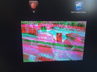

  • Hi Karthik..no it is still doesn't work. If it is help ...it is look like this..
    BR, Oleg
  • Oleg,
    It seems like the original issue of the GStreamer crash is resolved. Please confirm that.
    I cannot make out very clearly what that image corresponds to but it looks like you are getting something on the screen. You may need to investigate the pipeline further if you have just got to this point.
    Karthik

  • I'm sorry, Karthik I was wrong here...it is seems like problem with pipeline settings. The reason of this errors  was stoped weston and matrix on 06_03_00_106. I did couple of tests it is work fine. I will close this question but I didn't understood why you close my previous question about enconding 4stream ???
