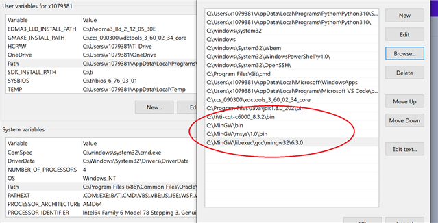

    2. Add "bin" folder in mingw installation to "Path" variable under "User" environment variable.
    3. Use "MingW terminal" and goto the location: “C:\ti\pdk_c665x_2_0_16\packages\ti\boot\ibl\src\make\”
