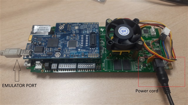

    1. Install CCS 9.3 from CCSTUDIO_9.3.0.00012 | TI.com
    2. In your C6657 EVM - board ----> You should put the DIP Switch settings in "No boot mode"  to connect to the CCS.
      That is  ------> DIP SW3 : 0 1 1 1 1 1 1 1 and DIP SW5 : 1 1 1 1 1 1 1 1
    Connection Details:
    Either download this video before watching or use the maximize button, " [[ ]]"  before playing.
    Please follow the steps as per the video, below.
