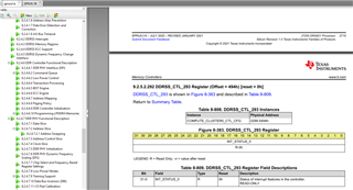

  • Hello, Brijesh
    I compare the DDRSS_CTL_293 register between DRA821 and TDA4XVM, and the descriptions are the same.
    And I go through the DRA821 TRM, there is none bit which can be polled for BIST completion.
    TDA4:
    DRA821:
