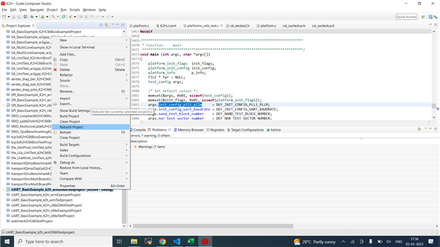

    Now Import the CCS project into CCS and go on
    1. To Import the project, Go to File -> Import -> "CCS projects" in "C/C++" -> Browse "Select Search-directory". make sure to uncheck the "Copy Projects into Workspace" (This is to avoid compilation errors only If TI-RTOS SDK was installed in a different location than "C:\ti\").

    4. Now, Re-Build the project by selecting the project and then right-click to select "Rebuild".
      1. Check for the "Build Finished" message without errors and valid warnings.

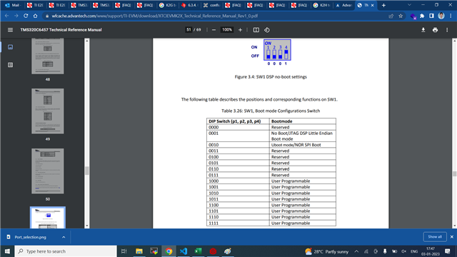

    5. Now, Make sure the device is in No-Boot mode for emulation.  as mentioned in the Technical reference manual https://wfcache.advantech.com/www/support/TI-EVM/download/XTCIEVMK2X_Technical_Reference_Manual_Rev1_0.pdf

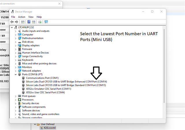

    6. Now, Identify the USB port in the Device manager
