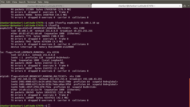

    2. host/server network configuration - Set the ip address manually.

    No Ip address is set above, so pls set manually like below.
    sudo ifconfig enp0s31f6 10.100.1.10 up
    ifconfig

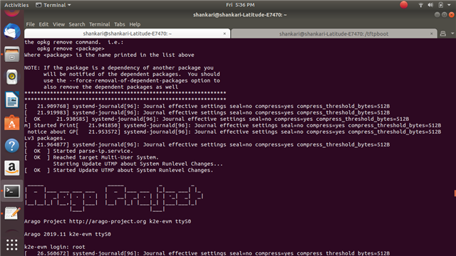

    Rootfs on NFS:
    setenv bootcmd 'tftpboot 0x82000000 zImage-shankJuneTenth;tftpboot 0x87000000 skern-k2e-shankJuneTenth.bin;mon_install 0x87000000;tftpboot 0x87000000 keystone-k2e-evm-shankJuneTenth.dtb;bootz 0x82000000 - 0x87000000'
    Use when board to server connects on network using 1:1
    Use when down port is used (tested)
    setenv bootargs 'earlyprintk debug console=ttyS0,115200n8 ip=10.100.1.11:::::eth0:off rootwait=1 root=/dev/nfs nfsroot=10.100.1.10:/home/shankari/ti-processor-sdk-linux-k2e-evm-06.03.00.106/targetNFS,v3,tcp rw'
    boot
