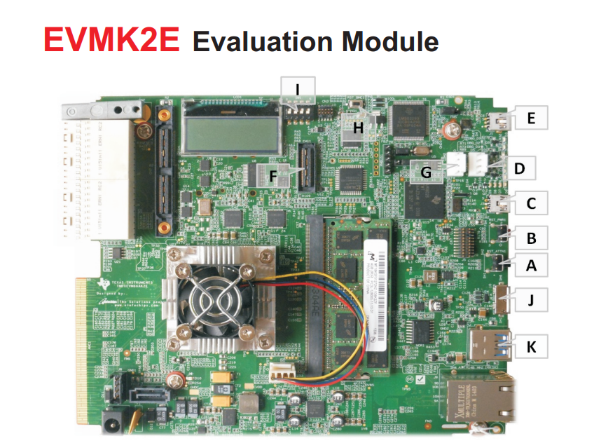

How to run the K2E EVM’s out of box demo.
---- Please downoad and follow the instructions and the connection settings given in the quick start guide below.
- EVMK2E _Quick_Setup_Guide.pdf
