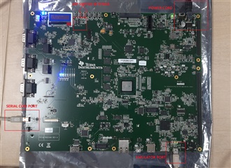

    Connection and hardware setup:
    1. DIP Switch settings : - Boot Mode SEL - SW3 - 00000 - No boot mode - For CCS
    2. Connect Mini usb cable between the XDS USB port on the EVM and the PC-usb port.
    3. Connect Mini usb cable between the USB-uart port  on the EVM and the PC-usb port.
    4. Disable the DB9 uart switch settings - SW12.
    4. In PC, open the device manager and detect the COM port number for the USB-uart connection and feed it in Teraterm or putty.
