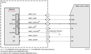

  • Hi Board designers,
    MMC0 PCB Connectivity Requirements
    we have issues with an eMMC connected to MMC0 of a AM6254 processor on a custom board.
    In the datasheet of the AM625 processors we found layout requirements for the MMC0 interface.
    Does this "min" specification mean that the traces of the MMC0 interfaces MUST have a minimum length? If yes can you specify this in inches or mm?
    Yes, there is a minimum trace delay requirement for this peripheral.
    The delay values are defined with the unit of picoseconds (ps). You will need to determine the propagation velocity of each signal trace on your specific PCB design to know how much additional trace needs to be inserted to achieve the appropriate delay.
    Sreenivasa
    To implement UHS-I refer below steps:
    The SD card interface pullups have to be connected to the 3.3V_1.8V VDDSHV_SDIO switched supply output from the PMIC
    The SD card needs to be powered using a fixed 3.3V supply.
    The 3.3V supply to the SD card needs to be switched through a power switch
    Provision to reset the power switch using SOC IOs is recommended
    An ANDing logic is recommend to reset the SD cars power switch.
    The SOC VDDSHV5 supply needs to be connected to the .3V_1.8V VDDSHV_SDIO switched supply output from the PMIC

    (39) AM6442: Why only emmc0 can support emmc flash - Processors forum - Processors - TI E2E support forums
    on AM64x, EMMC0 can connect to emmc flash and emmc1 can only connect to sd/sdio, as emmc don't need SDCD and SDWP, and other pins are same , though the support spec are different:
    emmc0: eMMC Electrical Standard 5.1 (JESD84-B51),
    sd1: SD Host Controller Standard Specification 4.10 and SD Physical Layer Specification v3.01
    customer want to know why emmc1 can not connect to emmc flash, is it only caused by spec difference?
    This point will impact their total system design, could you clarify?
    Because the design team only closed timing of the MMC0 peripheral for operating with eMMC devices and only closed timing of the MMC1 peripheral for operating with SD Cards.
    (40) LP-AM243: Regarding the MMC1 and μSD card usage - Arm-based microcontrollers forum - Arm-based microcontrollers - TI E2E support forums
    • You need to turn on the receiver associated with the CMD and CLKLB IO cells.
      The CMD signal is bidirectional, so the IO cell associated with this pin needs to have its receiver enabled.
      The pad associated with the CLKLB IO cell is not bonded to a device pin and it is used to loop a clock through the IO cell and back into the device such that the internal circuits operate from a delayed clock with similar delay that is introduced in the CLK output buffer plus the delay introduced in the DAT input buffers. This is done to help with read timing closure. The internal circuits will not have a clock unless you enable the receiver associated with the unbonded CLKLB IO cell.
      There is a note attached to the MMC1 Signal Descriptions table in the datasheet that tells you to keep the default state for the receiver enable associated with PADCONFIG164.
      Any pull-ups connected to MMC1 signals must be sourced from the VDDSHV5 power source that changes it operating voltage from 3.3V to 1.8V as the transfer speed increases. They should not be connected to a fixed 3.3V power source.
      I just realized the note attached to the MMC1 Signal Descriptions table should say:
      For MMC1 to work properly, the RXACTIVE and TX_DIS bits of the CTRLMMR_PADCONFIG164 register must remain in their default state because of retiming purposes.
      The original note did not mention the TX_DIS bit requirement.
      I would prefer to have CLKLB removed from the SYSCONFIG tool to avoid any chance of someone changing the default state of the RXACTIVE and TX_DIS bits of the CTRLMMR_PADCONFIG164 register, which is the PADCONFIG register associated with the unbounded MMC1_CLKLB IO cell.
      Then we would remove the note from the MMC1 Signal Descriptions table because these bits already default to the proper state. The note is only need now because the SYSCONFIG tool is providing a way for customers to accidently change them to an invalid state.
