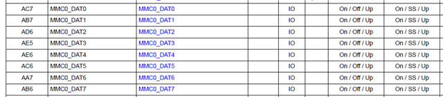

    The Pullup recommendations depend on the eMMC PHY implementation
    AM62x, AM62L, AM62Ax and Am62D-Q1 implement soft PHY
    In soft PHY implementation, the MMC0 pins have alternate functions that can be configured.
    Connect external pullup resistor for the data line (MMC0_DAT0) (close to eMMC device).
    eMMC device (as long as the eMMC device is compliant to the eMMC standard) has the pullups enabled for data signals
    D7..D1 by default. The eMMC device will turn off its D3..D1 pulls when entering 4-bit mode and D7..D1 pulls when entering 8-bit mode.
    The eMMC host software should turn on the respective DAT pulls when it changes the mode.
    (+) [FAQ] AM62A7: MMC0 Pull Resistor Requirements - Processors forum - Processors - TI E2E support forums
    This e2e exchange: AM6442: eMMC pull-ups necessary or not?, results in a statement that the AM6442 requires no external pull resistors on the MMC0 interface, and that the processor will provide all required pull levels.  Is this also the case for the AM62A processors?
    No. You must connect an external pull-down on CLK, and external pull-ups on CMD and DAT0 to prevent these eMMC device inputs from floating until software initializes the host controller and AM62Ax IOs associated with MMC0. The eMMC standard requires an eMMC device to have internal pulls turned on by default on DAT[7:1], so these signals do not require an external pull-up resistor. Software should turn on the respective internal AM62Ax DAT pull-ups when the bus width is increased from 1-bit mode to 4-bit or 8-bit mode.
    This is required on AM62A because the IOs associated with MMC0 are implemented with standard dual-voltage LVCMOS IO cells with the capability of multiplexing additional signal functions to the respective device pins. Therefore, these MMC0 IOs are turned off by default since it is unknow what may be connected to these pins. That is not the case for AM64x since it's the MMC0 port is dedicated to eMMC.
    The AM62x IOs used for MMC0 will power-up in the off state until software configures them. eMMC devices are required to have internal pull-up resistors on DAT[7:1], but they are not required to have internal pull resistors on CLK, CMD, and DAT0. External pull resistors are recommended for CLK, CMD, and DAT0 to prevent floating inputs on the memory device while waiting for software to configure the AM62x IOs.
    (+) [FAQ] AM62: Power sequence of VDDSHV_MMCx - Processors forum - Processors - TI E2E support forums
    The on-board eMMC device is connected to MMC0 and the IOs associated with this port are powered by VDDSHV4. The on-board eMMC device does not need to change voltage dynamically, so VDDSHV4 is connected to a fixed 3.3V or 1.8V supply. Typically on-board eMMC devices are operated at 1.8V.
    The SD Card is connected to MMC1 and the IOs associated with CMD, CLK, and DAT[3:0] are powered by VDDSHV5. These are the IOs that must change their operating voltage dynamically. So the VDDSHV5 power source must default to 3.3V and change to 1.8V when software is ready to change the IO voltage. The IOs associated with SDCD and SDWP are powered by VDDSHV0. These signals only connect to mechanical switches in the SD Card socket and should be pulled high with external pull-up resistors connected to VDDSHV0.  VDDSHV0 can be 3.3V or 1.8V and is not expected to change voltage.
    The SD Card is powered by a fixed 3.3V source and it has a similar internal power supply circuit that changes its IO supply from 3.3V to 1.8V when software sends a command telling the card to change voltage.
    There must be a software switchable 3.3V power source that provides power to the SD Card and the VDDSHV5 power source. The 3.3V power switch is required to cycle power to the SD Card and the VDDSHV5 power rail at the same time anytime the SD Card needs to be reset. Cycling power to the SD Card is the only way it can be reset since there is no reset signal on SD Cards. Without this power switch you would need to cycle power to the entire system to reset the SD Card. The SD Card must be reset anytime it has previously operating at 1.8V and needs to return to 3.3V mode. One good example where you may encounter this problem is when the watchdog timer expires and causes the processor to reset, which will return its VDDSHV5 IO voltage to 3.3V  and the SD Card will still be in 1.8V mode because power didn't cycle. This is a requirement defined in the SD Card specification.
    AM62Px / AM64x / AM243x (ALV) implements a hard PHY
    In hard PHY implementation, the MMCO pins have dedicate eMMC functionality. When not used, it is recommended to connect these pins as per the pin connectivity recommendations of the specific device data sheet.
    No external pull resistors are required for MMC0 since the PHY includes and dynamically controls the internal pull resistors as required for an eMMC.
    Pullups for D7..D0 and CMD are internally enabled during reset and after reset by the processor eMMC PHY.
    Pulldown is enabled for the DS pin and the clock output is driven low during reset and by the SS (The subsystem selected with MUXMODE determines the output buffer state) after reset.
    There are no PADCONFIG registers associated with the MMC0 pins.
    The internal pulls associated with the MMC0 pins are dynamically controlled by the MMC0 host and PHY.
    Provision for External pulls are not a requirement for the eMMC data, CMD, DS and the CLK signals.

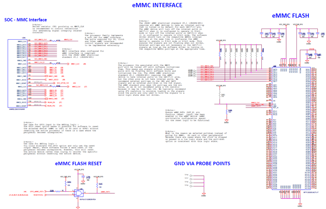

    2. Power supply and Sequencing
    The recommendation is to power the processor IO supply rail and the eMMC device from the same power source
    3. Series resistor for eMMC clock output from the processor
    it is  a good idea to place a series termination resistor as close as possible to the MMC0_CLK pin in case it is needed to dampen reflections caused by an impedance mismatch.
    Peripheral Clock Output Series Resistor
    Series resistor on the clock output near to the processor clock output (MCSPI, MCASP) pins are recommended for possible reflection control (signal distortion) at the source of the clock output since the clock is also being used for retiming.
    For MMC0, MMC1, MMC2, OSPI0, GPMC0 interfaces, an unbonded pad is used (internal) for retiming. We do not use the same clock that is sent across the PCB to the attached device for our capture clock. We branch the output clock into two paths inside the device, where the clock is sent to two separate IO cells. One IO cell is connected to a package ball, which is used to source a clock to the attached device. The other IO cell is unbounded (not connected to any package ball). The clock we use as the receive capture clock is sent out through the unbounded IO cell and looped back into the device before being used as the capture clock. We do this so the clock has the same delay that is inserted on the clock going out to the attached device and the same delay that is inserted on the data coming back in from the attached device. The unbonded IO cell pad never experiences the voltage step that is produced on the source end of a PCB signal trace. A low value series resistor (0Ω to start) is recommended (provisioned) to control possible signal reflections (signal integrity purpose).
    4.Series resistors for Data and command signals
    This is not a requirement. Optionally the series resistors can be included to  improve signal integrity and custom board design/layout dependent.
    5. Calibration resistor
    Refer to the device specific data sheet for the recommendations including the resistor value.
    6. Alternate Part recommendations
    TI doesn't make specific component recommendations.
    From the hardware perspective the MMC0 port on the AM6 devices are  compatible with the eMMC standards. So there should not be any hardware issue operating with any eMMC compliant device. See the MMC0 timing section of the datasheet for the eMMC data transfer modes supported.
    7. Are these recommendations valid for AM64x
    AM64X implements hard PHY similar to AM62P. AM62P and the general queries 2..6 can be followed.
    8. Is the  reset ANDing logic for the device required and any recommendations?
    The ANDing logic provides flexibility to reset the attached memory device. Refer SK schematics for implementation.
    RESETSTATz output will satisfy the power-on and warm reset functions and can be used to reset the attached device. Ensure IO level compatibility between the RESETSTATz output and the attached device reset input. You will need a two input AND gate to insert the software controlled GPIO reset function for the case where software needs to initiate a reset to only
    A pullup and an isolation resistor is recommended for the SoC IO output connected to the ANDing logic near to the AND gate.
    When ANDing logic is not used, verify the IO compatibility of the SoC reset status output used and the attached memory device.
    9. What is the default drive strength and can the drive strength be controlled?
    These are typically about 40 ohms, but the customer should be using the IBIS model to determine the drive strength of the pins.
    The drive strength must remain in the default state since this is the only condition used during timing closure of the peripherals.

    Refer below explanation regrading eMMC interface
    The AM62x IOs associated with the MMC0 port will be turned off until software initializes them. This means any signals without internal pulls will be floating until software boots and initializes the IOs. The eMMC standard requires the eMMC device to have internal pulls on the DAT[7:1] pins, but the other pins do not have internal pulls. We recommend external pull-ups on the CMD and DAT0 signals and an external pull-down on the CLK signal. The eMMC standard also says 10k pull-ups are the min value, so we do not recommend using a 10k resistor because it may be less than 10k. We typically recommend using 47k resistors to minimize loading on the signals since the pulls are only used to hold the signals in a valid logic state when not driven. Therefore, I suggest changing the value of your pull resistors and installing the pullup for CMD.  I do not expect these changes to have any effect on the issue you are seeing, but these changes should be made to ensure long-term device reliability.
    Question I notice the clock rise/fall time is not very fast probably due to the 33ohm series resistor.  Does it make sense to ask them to try reducing this value?
    I would not expect it to help because the setup and hold times already have margin. It may improve the clock rise/fall time, but there is good chance the signal will have more distortion due to reflections. They can try it to see what happens.
    (+) AM625: AM625 schematic checklist on MMC interface - Processors forum - Processors - TI E2E support forums
    The pull-down is only needed to hold the CLK input of the attached device in a valid logic state until software initializes the MMC0 host subsystem and the associated IOs. A 10k pull-down resistor should be a good choice for this use case.
    Note: Most of the AM62x IOs are turned off by default to prevent any potential conflict with attached devices. This is done because these IOs support multiple signal functions via pin multiplexing and TI doesn't know what will be connected to multiplexed pins. External pulls may be required to hold inputs of any attached device in a valid logic state until software initializes the respective IOs. The CLK case described above is a good example, where an external pull should be used to protect the attached device from a floating input.
    The series termination resistor value of 22 ohms was accidently carried over from another document that represented a different IO cell design, which had a lower source impedance. The 22 ohms series resistance helped match the output buffer source impedance to the PCB trace impedance. The source impedance of the IO cell implemented in AM62x is higher, so there is a good chance the series resistor is not needed. However, we encourage customers the keep the series resistor just in case their PCB design needs some additional series resistance to eliminate reflections due to impedance mismatch.
    Sreenivasa

  • Hi Board designers,
    The JEDEC eMMC standard defines internal pulls to be implemented in the eMMC device for data lines DAT1-DAT7. Immediately after entering the 4-bit mode, the device disconnects the internal pull-ups for DAT1-DAT3. Correspondingly, immediately after entering to the 8-bit mode the device disconnects the internal pull-ups for DAT1–DAT7.
    The standard also defines host pull requirements for each signal except CLK, and says the host is expected to provide pull-ups to protect the CMD and DAT signals from floating when all device drivers are in a high-impedance state. Two pull-up types are defined for CMD, where ROD is switched on and off by the host synchronously to open-drain and push-pull mode transitions. The other option is a fixed RCMD pull-up when the host does not allow the switchable ROD implementation.
    How we determined the 47K value. Do we have recommendations on what these values should be?
    All eMMC devices are required to turn on their internal pull-ups on DAT[7:0] to protect inputs from floating because it is not known if the eMMC device will be connected to a 1-bit host, 4-bit host, or 8-bit host.
    There is not such protection for the CLK, CMD, and DAT[0] inputs because the eMMC device assumes it will be connected to a host that is always sourcing these signals.
    That is not the case for some of our MMC ports. The IO cells associated our MMC ports implemented with SDIO buffer types will be turned off by default, which allows the eMMC CLK, CMD, and DAT[0] inputs to float.
    CMOS inputs should never be allowed to float, so we tell customers they must install an external pull-down on the CLK signal and a pull-up on each of the CMD and DAT[0] signals for these MMC ports to protect the eMMC inputs until the device has booted and software has enabled the associated IOs and MMCSD host controller.
    For these MMC ports, we never need to turn on our internal pulls for the CLK, CMD, and DAT[0] signals since the customer should be installing external pulls on these signals.
    The eMMC device will turn off its internal pulls on DAT[3:1] when entering 4-bit mode or turn off its internal pulls on DAT[7:1] when entering 4-bit mode because it expects the host to provide this function on all of its DAT signals. This means we should be turning on our internal pull-ups on the same signals when entering 4-bit or 8-bit mode, at the same time the eMMC device is told to enter either of these modes. However, our eMMC software driver is not able to access the PADCONFIG registers. So we have decided to turn our DAT[7:1] internal pull-ups in one of the early boot codes so they are already turned on before the eMMC host enters 4-bit or 8-bit mode.
    No external pulls are required for our MMC ports implemented with the eMMCPHY buffer type (MMC0 on AM64x, AM243x, and AM62Px) because the signals will be driven and/or pulled to valid logic states as soon as the processor is powered.
    The eMMC standard requires the pulls to be in the range of 10k to 100k, with a recommendation to be in 10k to 50k range when operating at 1.8V. We typically recommend an external 47k pull-up on the CMD and DAT signals. This allows the combined parallel pull (internal in case the pullups are enabled unexpectedly + external pullup) resistance to remain within this range defined by the eMMC standard.
    The eMMC standard doesn’t define a pull-down resistance for CLK, so we recommend an external 10k to reduce noise immunity when the signal is not driven.
    Information related to eMMC reset configuration
    [FAQ] AM62x: How to check and configure eMMC flash RST_N signal to support WARM_RESET from eMMC booting on AM62x-SK E2
    https://e2e.ti.com/support/processors-group/processors/f/processors-forum/1168342/faq-am62x-how-to-check-and-configure-emmc-flash-rst_n-signal-to-support-warm_reset-from-emmc-booting-on-am62x-sk-e2
    https://e2e.ti.com/support/processors-group/processors/f/processors-forum/1500901/tda4vm-this-is-a-question-about-emmc-boot/5769543
    In case of eMMC ,reset can be done in 3 ways:
    • CMD0
    • HW_Reset
    • Power cycle
    CMD0:(S/W RESET)
    Sending CMD 0 with specfic arguments will do software reset of the eMMC .
    H/W reset:
    The h/w reset can be done by sending the RST_n signal .
    By default, the RST_n signal is temporarily disabled in the dev
    ice.
    • The host must set ECSD register byte 162, bits[1:0] to 0x1 to enable this functionality before the host can use it.
    I am also attaching the JEDEC SPEC FOR EMMC which contains the details regarding resetting the eMMC which I would recommend going through:
    JESD84-B51 (1).pdf
    Please check below and let us know any suggestions.
    It is not clear why the external pull-up resistors associated with CMD and DAT0 signals were highlighted, but I will explain why they are recommended. The AM62x IOs used for MMC0 will power-up in the off state until software configures them. eMMC devices are required to have internal pull-up resistors on DAT[7:1], but they are not required to have internal pull resistors on CLK, CMD, and DAT0. External pull resistors are recommended for CLK, CMD, and DAT0 to prevent floating inputs on the memory device while waiting for software to configure the AM62x IOs.
    My only concern with the connectivity shown above is related to the eMMC device reset. I assume "NON" means do not install this component, and I see "NON" on components R237 and TR14. It is not possible to reset the eMMC device without these devices installed. The eMMC device reset source should be designed to assert reset during power-on and release reset by default, so it is ready to communicate with the AM62x host once it is initialized by software. We also recommend a reset implementation that automatically resets the eMMC device if there is a watchdog or software initiated reset to the AM62x device, so the eMMC device is also reset at the same time. It is not possible for me to comment on this implementation since this schematic doesn't show the source of eMMC_RST. However, the eMMC_RST source is not relevant when R237 and TR14 are not installed.
    Sreenivasa
    Inputs related to pullup configuration
    The AM62x / AM62D-Q1 / AM62Ax / AM62Px / AM62lL processor IOs associated with the MMC0 port will be turned off until software initializes them. This means any signals without internal pulls will be floating until software boots and initializes the IOs. The eMMC standard requires the eMMC device to have internal pulls on the DAT[7:1] pins, but the other pins do not have internal pulls. We recommend external pull-ups on the CMD and DAT0 signals and an external pull-down on the CLK signal. The eMMC standard also says 10k pull-ups are the min value, so we do not recommend using a 10k resistor because it may be less than 10k. We typically recommend using 47k resistors to minimize loading on the signals since the pulls are only used to hold the signals in a valid logic state when not driven.
    (+) AM625: AM6254 don’t start up from eMMC in -30 degree. - Processors forum - Processors - TI E2E support forums
    You should have an external pull-up on DAT0 because the eMMC device doesn't have an internal pull on its DAT0 input. The eMMC standard requires any compliant eMMC device to have internal pulls on DAT[7:1].
    The AM62x device defaults with most of its pins turned off by default since many signal functions are multiplexed to pins and TI does not know how will be used until system aware software initializes the device. What I mean by turned off is the input buffer is disabled, the output buffer is disabled, and internal pulls are turned off. In your custom board the DAT0 signal will be floating until software initializes the AM62x MMC0_DAT0 pin. This is not a problem for AM62x at this point because the input buffer associated with MMC0_DAT0 is turned off, but it may be a problem for the eMMC device.
    This will be a problem for the AM62x once software enables the input buffer associated with this pin and this signal is not actively driven by AM62x or the eMMC device.
    Your product design must never allow any AM62x enabled input to float to a mid-supply voltage. There may be long-term reliability issues associated with any enabled input buffer that is allowed to float for extended periods of time with a potential that is greater than VILSS and less than VIHSS. You need to minimize the accumulated time a signal spends in the region between VILSS and VIHSS.
    (+) [FAQ] AM625 / AM623 / AM620-Q1 / AM625-Q1 / AM625SIP: eMMC0_DAT0 not enabled pull up by ROM - Processors forum - Processors - TI E2E support forums
    The eMMC standard requires all eMMC devices to have an internal pull-up that is turned on by default for each DAT[7:1] pin. The eMMC device will turn off the internal pulls on DAT[7:1] when it is configured to operate in 8-bit mode or turn off the internal pulls on DAT[3:1] when it is configured to operate in 4-bit mode. The software driver should turn on the respective AM62x internal pull-ups at the same time it configures the eMMC device to operate in 8-bit mode or 4-bit mode. This ensures the signals are not floating when not driven. External pull-ups are not necessary on the DAT[7:1] signals as long as the software driver is turning on the respective AM62x pull-ups at the appropriate time.
    The eMMC standard does not define any internal pulls for the other eMMC inputs because it assumes the device will be connected to a host that is driving or pulling these pins to a valid logic level as soon as power is applied. However, that is not the case for AM62x since most pins are shared with many signal functions. The shared pins will not know their assigned signal function until software boots and configures the respective PADCONFIG registers. The AM62x device turns off the IO transmitter, receiver, and internal pulls of most pins until software initializes them to the appropriate signal function. In the eMMC use case, the CLK, CMD, and DAT0 inputs would be floating until software initializes the IOs and the associated MMCSD host controller. Therefore, customers should have external pull-up resistors on CMD and DAT0, and an external pull-down resistor on CLK to prevent the eMMC inputs from floating while waiting for software to configure the AM62x pins.
    I suspect the pull-up is required on D0 to pull the signal high because the AM62x pin is configured to operate in open-drain mode during the initial communications with the eMMC device. The DO signal would never toggle high without the external pull-up.

    Inputs related to the Pin attributes for MMC0 signals for AM64x and AM62Px
    AM62P5-Q1: HW:  Confirmation of MMC0 Pin specifications
    Please tell me the specifications of "Electrical Characteristics" of eMMCPHY.
    AM62P
    Data sheet
    www.ti.com/.../sprsp89
    AM62Px Sitara Processors datasheet (Rev. B)
    The MUX MODE, DSIS, and MUX MODE AFTER RESET columns will remain blank for these pins since these cells in the table are not applicable because the pins are implemented with a hard macro PHY, which doesn't support the pin multiplexing logic.
    The HYS column should have a value of "No" since the input buffers associated with the PHY does not have hysteresis.
    The BALL STATE DURING RESET and BALL STATE AFTER RESET values will be as shown below:
    MMC0_CLK - On / Low / Off - On / SS / Off
    MMC0_CMD - On / Off / Up - On / SS / Up
    MMC0_DS - On / Off / Down - On / Off / Down
    MMC0_DAT[7:0] - On / Off / Up - On / SS / Up
    For electrical characteristics refer to the eMMCPHY Electrical Characteristics defined in the datasheet.

    #1. What is the purpose of 0ohm resistor for MMC0_CLK?
    #2. Software turn on DAT pulls when changes the mode, is pulls must required on DAT pins? if so, why eMMC device turn it off from on during switch?
    #3. Is it implemented in SDK to turn on DAT pulls when changes mode? did not find padconfig information in driver sdhci_am654.c
    1) The series resistor provides an option to install a 10 ohm to 33 ohm impedance to help attenuate reflections that return from the far end of the signal trace if needed to resolve signal integrity issues.
    2) The pull-up resistor R399 is Do Not Install (DNI), so it is not pulled up.

    And also according to the FAQ on deign recommendations/commonly observed errors during custom board HW design on eMMC memory interface:
    • We recommend external pull-ups on the CMD and DAT0 signals and an external pull-down on the CLK signal. The eMMC standard also says 10k pull-ups are the min value, so we do not recommend using a 10k resistor because it may be less than 10k. We typically recommend using 47k resistors to minimize loading on the signals since the pulls are only used to hold the signals in a valid logic state when not driven.

    2、What does the content shown in the following picture mentioned in the TRM manual mean? Does it support SD 4.10 and SDIO 4.0? So, should we follow the data manual or the TRM?
    The next revision of the AM62Lx datasheet will be updated to show with the following list of devices and data transfer modes supported for each MMC instance.
    The MMC0 port supports connections to an eMMC device or embedded SDIO device. It does not support removable SD Cards.
    The MMC1 and MMC2 ports support connection to a removable SD Cards or embedded SDIO device. They do not support eMMC devices.
    For the SDIO specifications, please follow the data sheet.
    The references to 4.x in the TRM will be updated.

    Input related to ANDing logic:
    after each reboot, RESETSTATz will be pulled low for 220 µs, and eMMC_RSTn is affected by the action of RESETSTATz.
     AM2434: What is effect of warm reset?
    Can you please confirm eMMC_RSTn (RST_N) pin function (Reset input) has been enabled in the eMMC device (eMMC

    (+) [FAQ] AM62x: How to check and configure eMMC flash RST_N signal to support WARM_RESET from eMMC booting on AM62x-SK E2 - Processors forum - Processors - TI E2E support forums
    Explanations on the issue observed:
    Micron eMMC datasheet [https://www.mouser.com/datasheet/2/671/micron_technology_mict-s-a0006806196-1-1759129.pdf]
    • RST_n: The RST_n signal is used by the host for resetting the device, moving the device to the pre-idle state.
    • By default, the RST_n signal is temporarily disabled in the device.
    How to check eMMC RST_n by reading eMMC ECSD register
    Boot to Linux, and kernel log below shows RST_n is NOT enabled on eMMC ECSD on one AM62x-SK E2 board
    root@am62xx-evm:~# mmc extcsd read /dev/mmcblk0 | grep -i RST
    H/W reset function [RST_N_FUNCTION]: 0x00
    How to enable eMMC RST_n by programming eMMC ECSD register
    The eMMC hardware reset signal RST_n can be permanently enabled by programming eMMC ECSD bits one-time only either @u-boot OR @kernel as listed below
    • @U-boot: => mmc rst-function 0 1
    • @Kernel: mmc hwreset enable /dev/mmcblk0. Note that “/dev/mmcblk0” is an example of the eMMC device mounted in Linux kernel.
    The kernel log below shows eMMC RST_n is enabled, and any WARM_RESET option would work now.
    H/W reset function [RST_N_FUNCTION]: 0x01
    Sreenivasa
