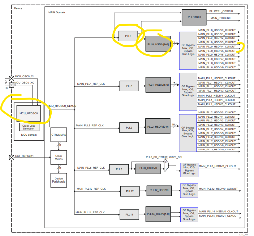

In AM6422 evaluation board SK-AM64B. It connect the EXT_REFCLK1 to CLKOUT0 signal. i have some question about it.
1. EXT_REFCLK1 is 3.3V. Why it connect to a 1.8V clock buffer. Will it damage the buffer?
2. If EXT_REFCLK1 output the signal to 1.8V buffer. How the clock generate from EXT_REFCLK1. looks like the buffer also support the main domain clock input. if the main domain doesn't has the input clock firstly, how the EXT_REFCLK1 generate clock signal. if I am wrong, how the circuit work?
 the PROC101D evaluation board has similar questions. looks like logic level is not same. And if the buffer CDCLVC1310 input is select to primary. how the main/mcu domain clock work firstly.
Shu

  • Hello Shu
    Please refer below. The same pin can be configured as Clkout0. The EVM configuration is a valid configuration that can be used when the SOC is configured for Crystal.
    6.3.22.3 System
    6.3.22.3.1 MAIN Domain
    CLKOUT0
    O
    RMII Clock Output (50 MHz). This pin is used for clock
    source to the external PHY and must be routed back to
    the RMII_REF_CLK pin for proper device operation. A19, U13

  • Hi Sreenivasa,
    That is my concern. looks like the EVM make the EXT_REFCLK1 to a clkout0 function, it is a output clock to a clock input buffer. the buffer is connected to SoC main clock input. So where is the first clock come from? if the SoC clock from a crystal, where the EXT_REFCLK1 clock go. In EVM, it go to same buffer input as the crystal. I don't think the buffer can use two inputs at same time.
    Shu
  • Hello Shu,
    The SOC CLKOUT0 can be used only to clock the EPHY and can only be used when a crystal is connected to the SOC oscillator.
    Sreenivasa
  • okay, that make sense.
