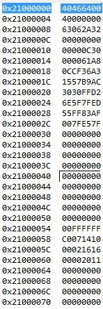

    2) After you configure DDR3-1333 and load your application code - and before you perform any CPU/non-CPU initiated traffic to DDR - please dump your DDR PLLCTL0/1 registers and DDR config space from 0x21000000 -> 0x21000100. As part of this debug, I want to take a look at why is it that you do not face an issue at this freq w/o leveling and also sanity check the config space values.
    I understand what your problem is. Please understand that these are debug steps that are necessary to eliminate variables and focus on what really is going on.

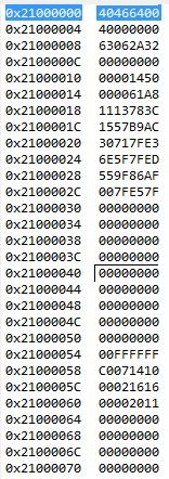

    3) Would it be possible for you to do the same as #2 with DDR-800 that does not work? Perhaps load your code in MSMC or L2 instead of DDR.

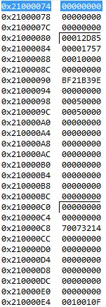

    2) I'm pasting the content of the registers after Ethernet load with DDR3-1333 configuration. First column is address and the second the value. Highlighted in blue is DDR3PLLCTL0. The following are DDR3PLLCTL1, PASSPLLCTL* and and SGMII_SERDES_CFG* registers.
    DDR3 configuration registers from 0x21000000 to 0x21000100 as you requested:

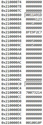

    3) Registers for DDR3-800 configuration:
    The first weird behaviour that can be seen it is for both configurations (even for DDR3-1333 for which everything works OK), 0x21000004 register (DDR3 controller status register) bit IFRDY is not stable (in captures above its value is '0', which is really bad, but if I step a few cycles, it becomes '1', and '0' again after a few cycles, and so on). In other words, IFRDY bit is blinking, which is not desirable at all.
    When configuring this from GEL/Emulator, that IFRDY bit is stable as expected (and of course at '1'). Last byte of DDR3 controller status register must be 0x4.
    But it is blinking from 0x4 to 0x0 when RBL Ethernet loading.
