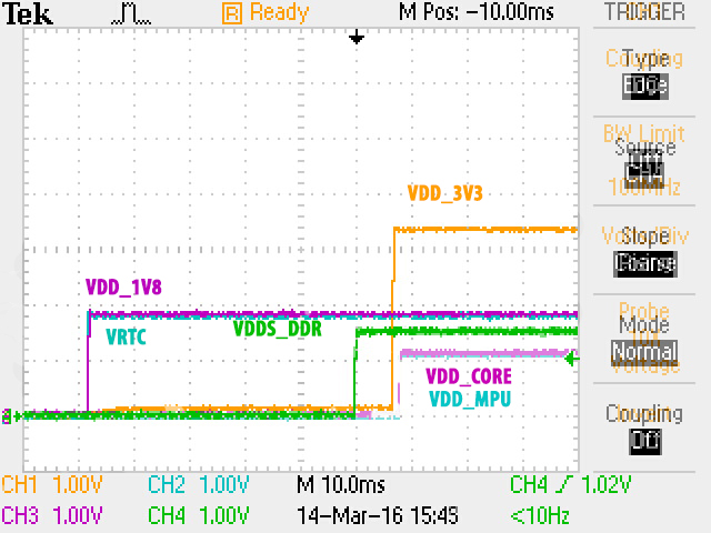

  2. Earlier versions of TPS65217C user guide had incorrectly assigned LS1/LDO3 to power AM335x VDDS rail. This assignment violates our AM335x data sheet power up sequencing. We worked with the PMIC team to get this addressed and therefore has changes in the Rev-I user guide. TPS65217C is programmed to have rails come up as LDO1 -> DCDC1 -> LS1/LDO3 -> LDO2 -> LDO4 -> DCDC2/3.

    As my circuit is configured, I have VDD_RTC on LDO1, VDDS_DDR on DCDC1, VDD_1V8 on LDO3, Nothing on LDO2, VDD_3V3 on LDO4, VDD_MPU on DCDC2, and VDD_CORE on DCDC3. The order that I listed them is the startup sequence as well. According to figure 6-4 in the am335x datasheet, I should be starting in the sequence RTC -> 1V8 followed by DDR -> 3V3 -> MPU& CORE. So I have 1V8 and DDR swapped in the sequence. Is that correct?

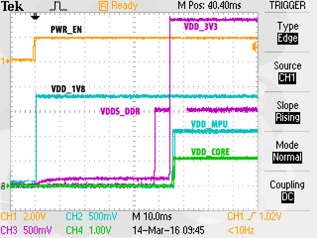

  • I ran a test of the proposed solution, driving PWR_EN to a separate regulator.   It seems to have resolved the sequence issue.   Please note that this is  photoshop overlay of two runs of the scope - so there are a couple of weird artifacts.  Please advise.

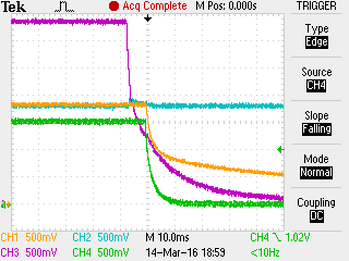

    Below is a scope shot showing part of the power down sequence.  In the simple case of connecting POWER_EN directly to the enable, the 1.8 volts ends up being the first thing to power down.  I will work on a complete power sequence for you, instead of only the 1.8V and DDR voltage that I have available in the image below.  Red trace is 1.8V and Blue is VDDS_DDR.
  • I think I know why you wanted to see VRTC - my mistake was thinking that it would always be on.  Actually it comes on with with the button press.  So is there enough time between VRTC coming up and VDD_1V8?  The datasheet says that it can be ramped independently.
    Poweroff you can see that the RTC voltage stays up, but that the 1V8 drops immediately, before everything else (and it is supposed to be last in the sequence)

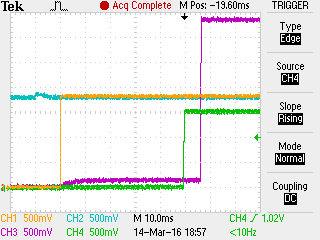

    Power up.  [Note that the leakage onto 3.3V has been resolved, I just don't have a full power sequence scope shot]
    the VDD_MPU and VDD_CORE voltage are last, after the 3.3V, but are not shown.

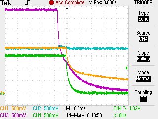

    Power down from command line:
    In my book, this works.  Can I get a thumbs up from TI?
  • I’m still struggling to see the full picture of the power-up/down sequencing along with the PWRONRSTn/RTC_PWRONRRSTn. However, the specific power down snapshot that was sent looks fine. There are a couple of other options that you can also consider here.
    Also, there seems to be some leakage into the 3.3V that needs to be fixed. The RTC rail also has a small glitch when switching from main power to battery. Please make sure the RTC power is measured after you changed the pull-up resistor to the VRTC rail

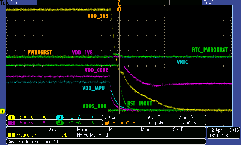

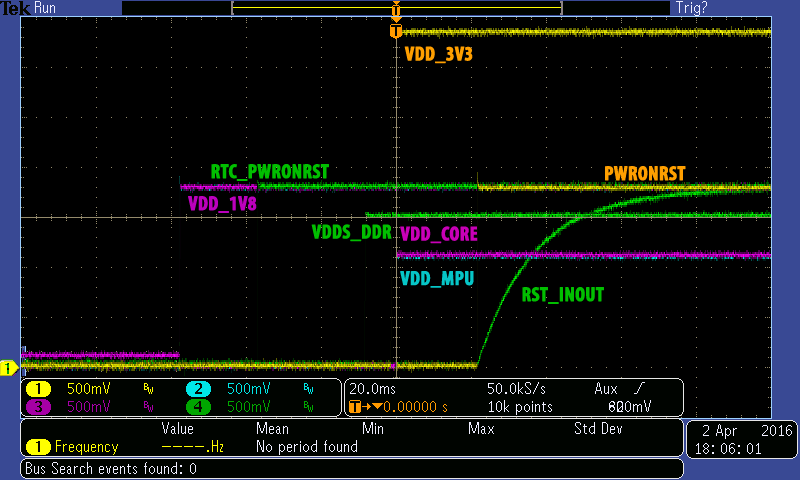

  • Siva - beena bit of a delay, because I wanted to capture the waveforms on the final board.   I think these look good. I hope you agree.   In either case, please provide your feedback:
    Power on:
    Power Off:
