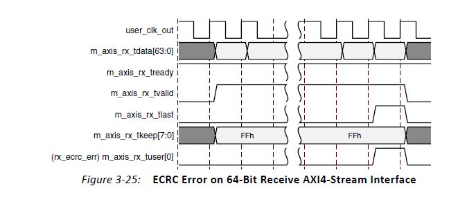

Using AM5728/C66x/TI-RTOS, the AM5728 communicates with a FPGA by PCIe and It works well. However, I test ECRC test function but It doesn't work.
(AM5728 supposed to send a corrupted TX TLP, FPGA couldn't  checked it).
To corrupt a PCIe TX TLP, I used PCIECTRL_TI_CONF_DIAG_CTRL register.

    Unfortunately, I don't have a such tool which scopes a PCIe packet. Therefore, I had to scope a received packet on RX side.
    Xilinx Artix-7 is also capable of generating and checking ECRC. For example, if the FPGA received a corrupted TLP, it generated a error flag(rx_ecrc_err).
    I ran above test code on AM5728 (C66x), then waited for an error flag on FPGA. However, I couldn't see in.
