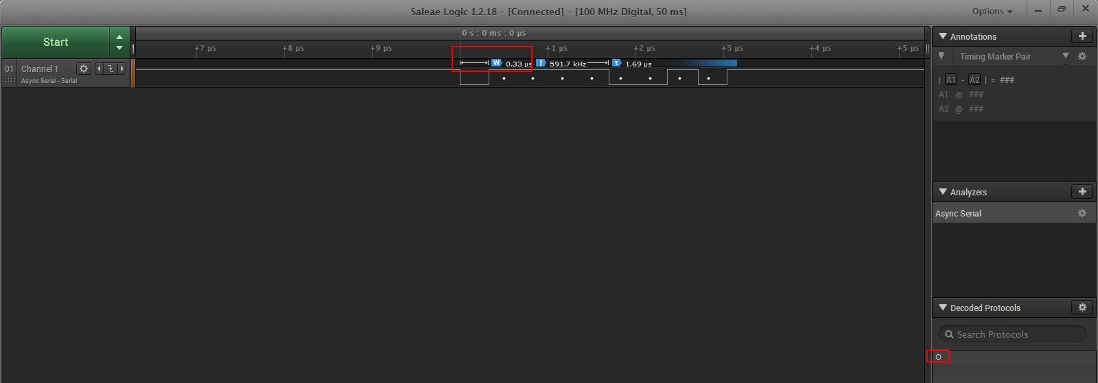

  • Andreas,
    I have been able to test changing the UART module clock to 192 Mhz on the AM572x using the UART3 instance that runs at 115.2 Kbps without issues. Here is the complete description of the changes.
    The UART module clock selection of 48 Mhz or 192 Mhz is controlled by a register in the PRCM module using a register called CM_L4PER_UART3_CLKCTRL. In order to set 192 MHz clocking, the CM_L4PER_UART3_CLKCTRL[24] needs to be set to 1. Refer to the register description in the TRM.
    To update this in the board library,  add the following code to the idkAM572x_clock.c above the UART module clock enable. Refer file attached
    	CSL_FINST(l4PerCmReg->CM_L4PER_UART3_CLKCTRL_REG,
            L4PER_CM_CORE_COMPONENT_CM_L4PER_UART3_CLKCTRL_REG_CLKSEL, SEL_FUNC_192M_CLK);

    I will attach a picture of my logic analyzer, which shows me that a character 'O' is being send but with the baud-rate of 3[Mbps]. Please check the start bit, which has the length of 0.33[us], but the desired bit-length is 0.4[us] for a 2.5[Mbps] baud-rate.
    Can you please check on your side, if you are able to transmit with 2.5[Mbps] when selecting this baud-rate inside the "uartParams" structure?
    Andreas
  • Andreas,
    Could you please indicate what over sampling rate are you using 16x or 13x ? Can you also indicate what value do you read from the UART_DLL and UART_DLH.
    I suspect that he issue here is with the incorrect setting of the UART divisor. Let me explain.
    Oversampling factor of 16
    When you are trying to compute the divisor to get ot 2.5 Mhz, the compute goes as follows:
    Divisor = 192000000/ (16*2500000) = 4.8 but in the UARTDivisorValCompute does an integer divide and round it to 4
    So resulting baud rate is
    Actual baud rate  = 192000000/ (16*4) = 3  Mbps
    If it was rounded to 5, the baudrate would be 192000000/(16*5) = 2.4 Mbps.
    Oversampling factor of 13
    Divisor = 192000000/ (13*2500000) = 5.9 but in the UARTDivisorValCompute does an integer divide and round it to 5
    Actual baud rate  = 192000000/ (13*5) = 2.953 Mbps
    If it was rounded to 6, the baud rate would be 192000000/(13*6) =2.461538
    How to fix the issue
    In the longer term setting the divisor to closest integer should be the final fix for this issue which we are tracking as part of the bug we have filed to set the divisor and oversampling more smartly in the UART_open.
    In the near term can you try a quick workaround. You can set the uartParams.baudRate = 24000000. this will set the divisors to 5 (for oversampling of 16 ) and to 6 (for oversampling of 13). this should get you within 5 % error and resolve the problem.
    Rahul
