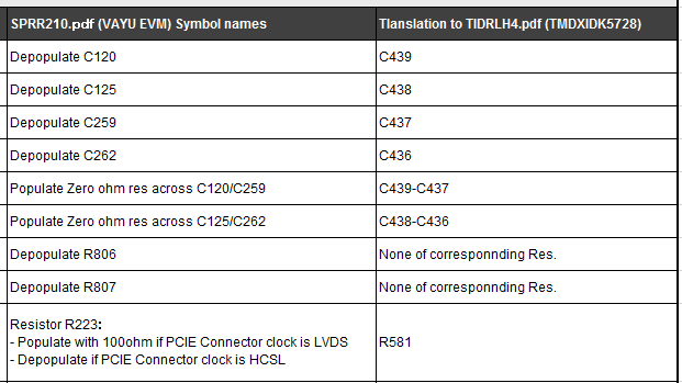

  • lding
    Thank you for your response.
    The H/W modification has not been tried.
    Your link explains based on J6 EVM.
    I tried to translate it to the TMDXIDK5728.
    Can I ask some?
    Q. Could yo please review my translation?
    Q. R806 and R807 were not found in our IDK. No problem?
    I asked our HW engineer to comment this.
    Regards, Eric
    The instructions in the table are correct but there is a big difference between implementing this on the VAYU EVM vs the TMDXDK5728.
    The VAYU EVM has the capacitors adjacent allowing a zero ohm resistor to be installed to short the REF_CLK on the PCIe connector to the SoC as shown below.
    The TMDXIDK5728 was not designed in this way. Connecting these signals on the TMDXIDK5728 will require a pair of twisted wires connected between the PCIe connector side of C436 and C437 to the SoC side of C538 and C539 as shown below. The wire must connect the pad on C438 to the pad on C436 and the pad on C437 to the pad for C439. They cannot be reversed. The wires must be kept at the same length.
    Regards, Bill
