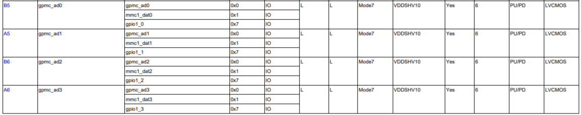

2) We add 4x debug leds.  They are connected respectively on B5, A5, B6 and A6.

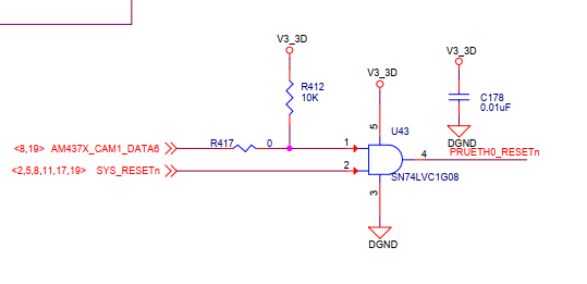

As I see from the schematics on the IDK board only Pin 20 is used for the reset

How can I understand that pin T20 belongs to SOC_GPIO4_REG group? Where do belong A5, B5, A6, B6?
I see that function GPIOPinWrite() is used to control the GPIO:
void GPIOPinWrite(uint32_t baseAdd,
                               uint32_t pinNumber,
                               uint32_t pinValue);
But how do I know the base address?
How do I know to which base address belongs any my pin?

    As far as determining which pin belongs to which group, please refer to the device datasheet. Table 4-10 describes pin attributes. In the table you will see the assignments for each pin:
    If you use the pinmux tool, the tool allows you to make pin assignments in addition to setting up the mux for the pins that you want to use. I hope the above information gives you an idea about how to go about configuring the additional pins that you have used on the custom board.

    As I see in EtherCAT demo the reset pin is set this way:
        /*PRUETH0_RESETn */
        PhyResetInfo[0].pin = 20;
        PhyResetInfo[0].baseAddr = SOC_GPIO4_REG;
    So that means it is GPIO4_20. In the AM437x datasheet we look for GPIO4_20:
    In the IDK schematics I see that it is exactly AD23 is used for reset:
    So it is not T20 used on IDK used to reset PRU as I thought before, it is AD23.
