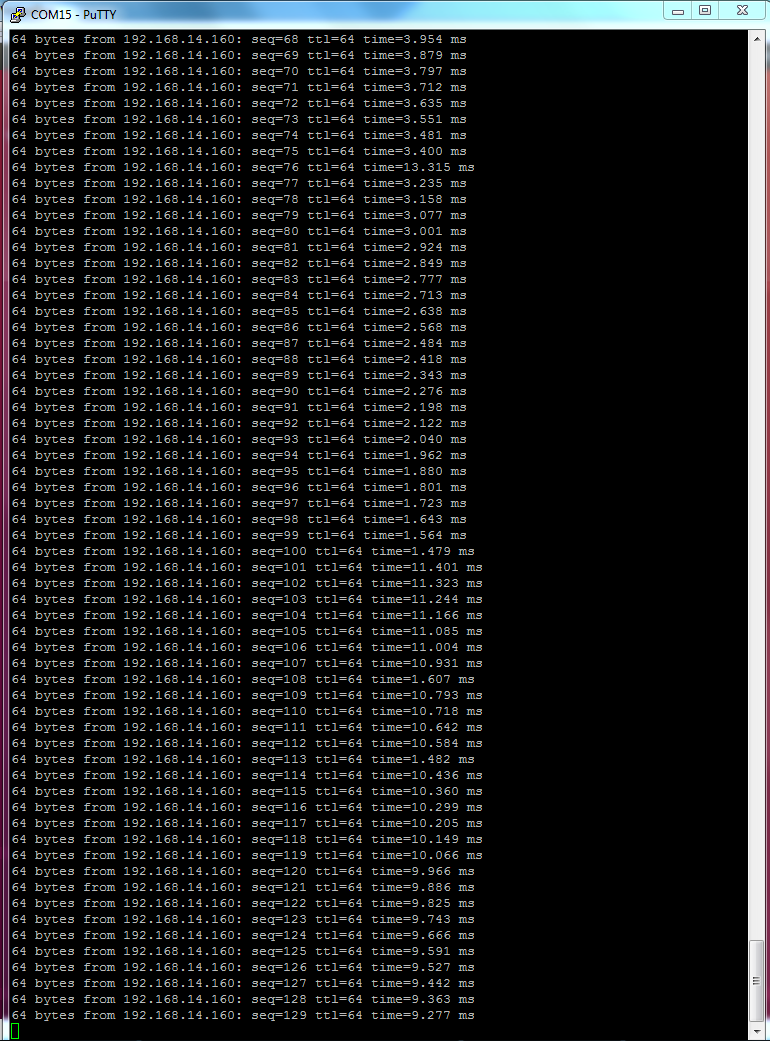

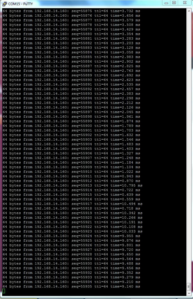

So, after the 2nd compilation of sdk, there are are the same bug in the ping: the ping is unstable.
Firstly, the ping is great, up to 10ms.
Then ping gradually decreases downto 0.7ms, and then is again 10ms.
And again.
When IDK pings the 127.0.0.1, the ping is 0.06ms stable.
