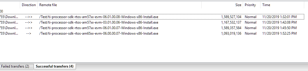

    My mistake, the SD card wasn't inserted.
    I was able to transfer 1-1.5GB sized files individually at ~3.7MB/s. With parallel transfers, I could only do two at a time. The third transfer would immediately fail. Please see screenshots below.
    This was on the LCDK.
    Sahin
