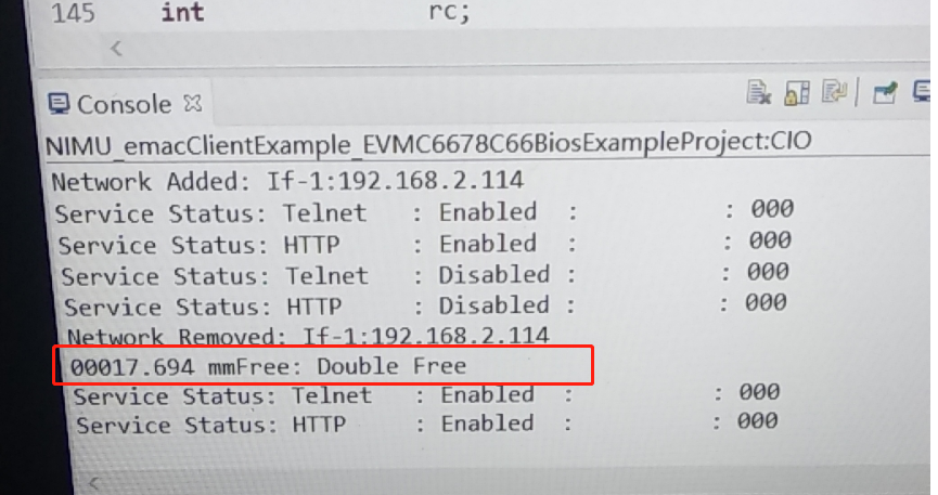

I test the NIMU_emacClientExample_EVMC6678C66BiosExampleProject , after telnet login , I use "reboot"  cmd ,
it comes as follows:
and Eric replied :

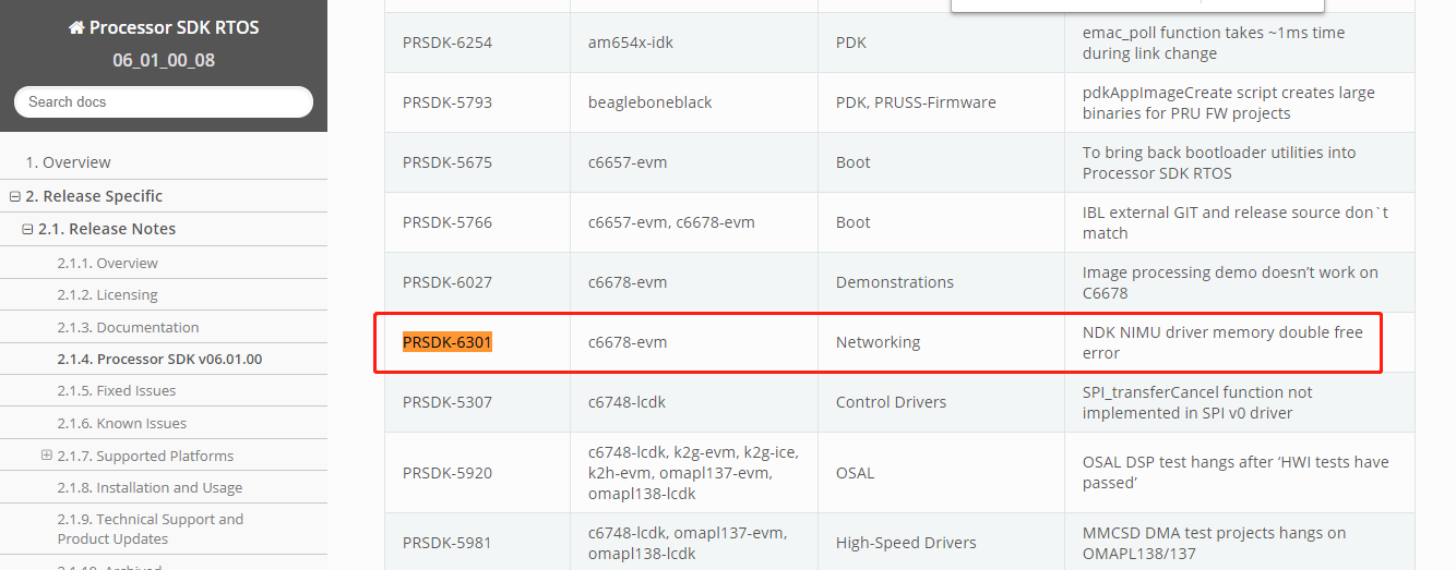

We have a bug opened to track this memory double free error: https://jira.itg.ti.com/browse/PRSDK-6301. You probably can't access the bug database but you will see when it fixed in our release note with this ID.
but, I test the process_sdk_06_01_00_08,, after telnet login , I use "reboot"  cmd ,
the "mmFree:Double Free" is disappeared,  but  the Net work  still not  reboot .why?

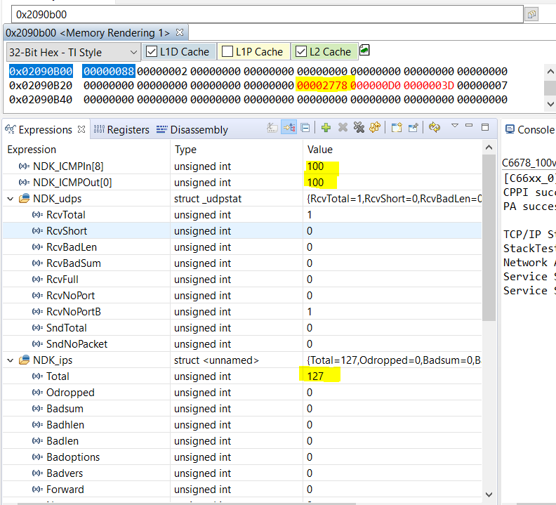

    So you tried the 0246.client_6678_restart_test.zip from Ivan and it didn't help? In the original NIMU NDK client demo, how do you came into NDK ICMP ping no response issue? E.g. Just power on the EVM, run the application, then ping it and it will be dead after a few days? Or, you run some (heavy) network traffic using TCP or UDP, then it will be dead?
    Did you debug it? E.g. when you ping it,
    1) Did the C6678 CPSW switch received the packets? You can look at the statistics starting from address 0x2090B34. This is SGMII port 0 Rx good frame counter and expected to increase.
    2) Then set a break point at EmacRxPktISR(), it is expected to hit
    3) Then look at NDK statistics, the highlighted in yellow expect to increase
    4) Then set a break point at EmacSend(), it is expected to hit
    5) 0x2090B00 this is CPSW Tx counter and expect to increase
    You need some debug where the path break.
    Regards, Eric
    Are you debugging the NDK failure? Is it in Tx path or Rx path?
