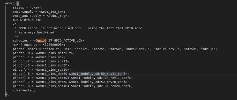

Hi all,
        We use tda2xx to communicate with MCU, the MCU send the packets to the tda2xx with 2ms period, and then wait 10ms for tda2xx reback the packets. When we remove the sd card from tda2xx board, the tda2xx generates an interrupt to handle related events(shown as below printfs), then it can't reback the packets from MCU within 10ms, it's so terrible for we need to reback the packets to MCU in time.
        What shall we do with the sd card removal events?Shall we do it with polling mode?

root@dra7xx-evm:~# [ 38.232174] mmc0: card 59b4 removed
Broadcast message from systemd-journald@dra7xx-evm (Fri 2020-04-24 09:14:08 UTC):
systemd[1]: Caught <ABRT>, dumped core as pid 25961.
systemd[1]: Freezing execution.
systemd-journald[127]: Failed to send WATCHDOG=1 notification message: Connection refused
systemd-journald[127]: Failed to send WATCHDOG=1 notification message: Connection refused………………(repeat this printf, and the tda2xx can't reback the packets to MCU with 10ms)
