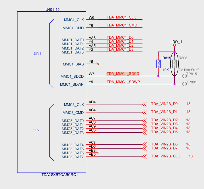

Hi all,

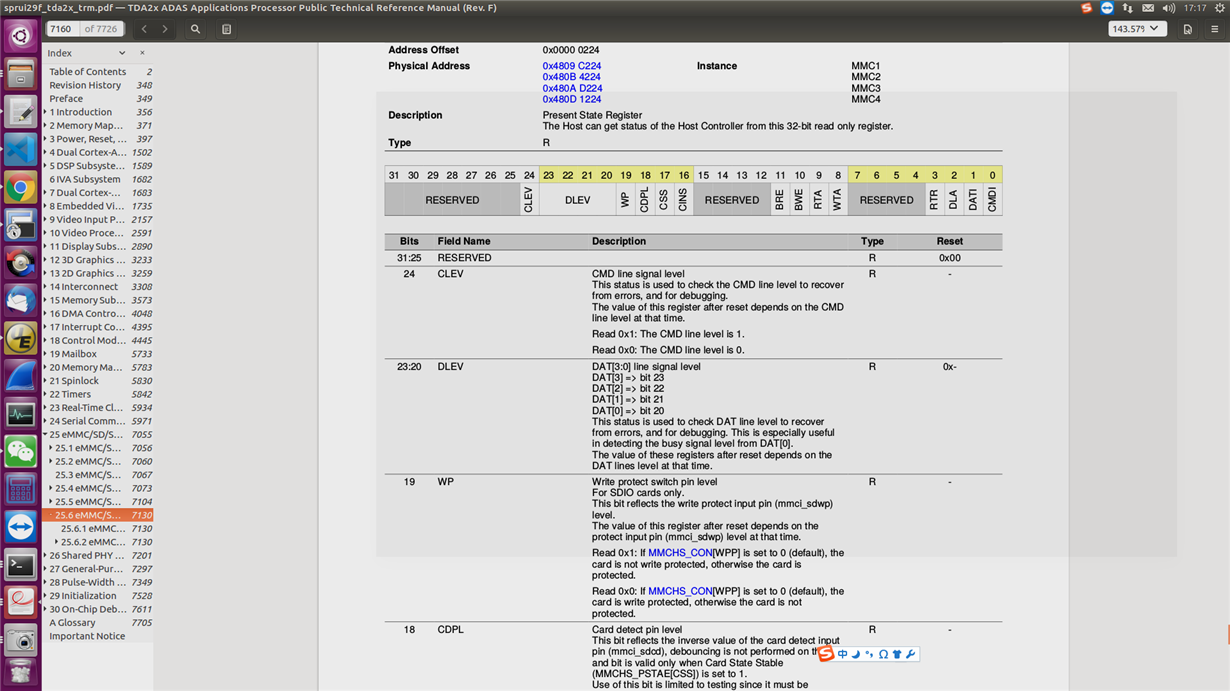

       we need to detect the sdcard sd-cd pin status after kernel is started, so I found the Physical Address of the mmc1 on TRM doc. which is shown below.
       but when we enter:omapconf read 0x4809C224,  it runs error:
root@dra7xx-evm:~# omapconf read 0x4809C224
[ 21.049540] Unhandled fault: asynchronous external abort (0x1211) at 0x00000000

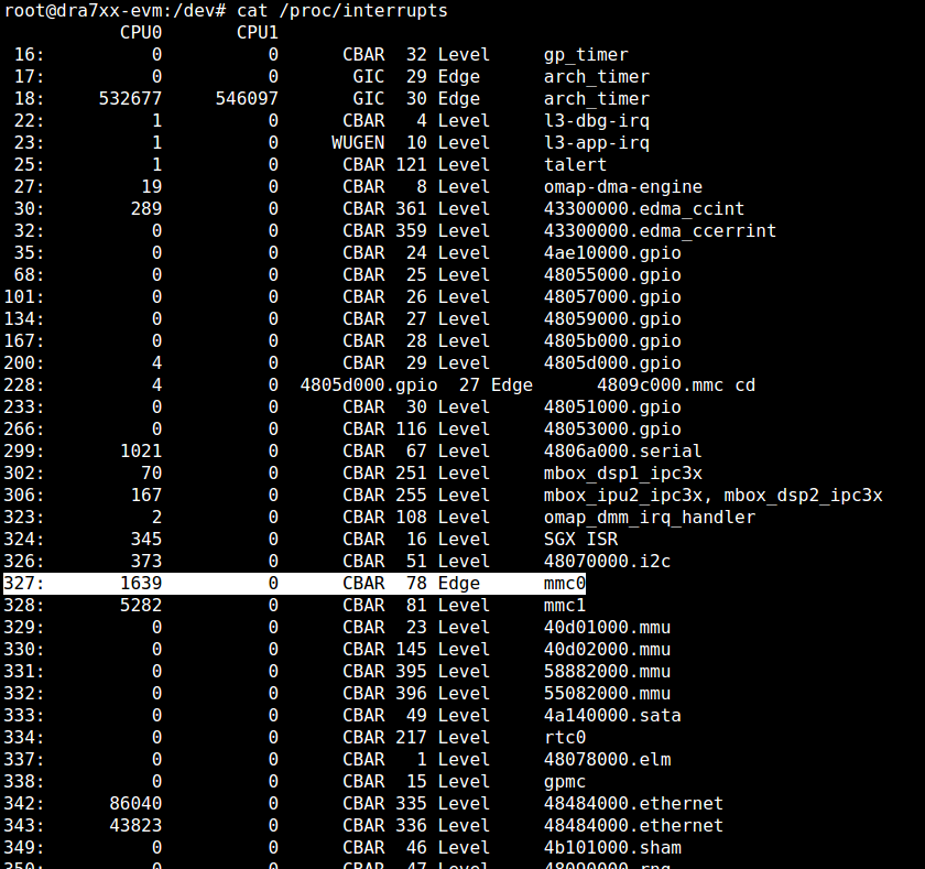

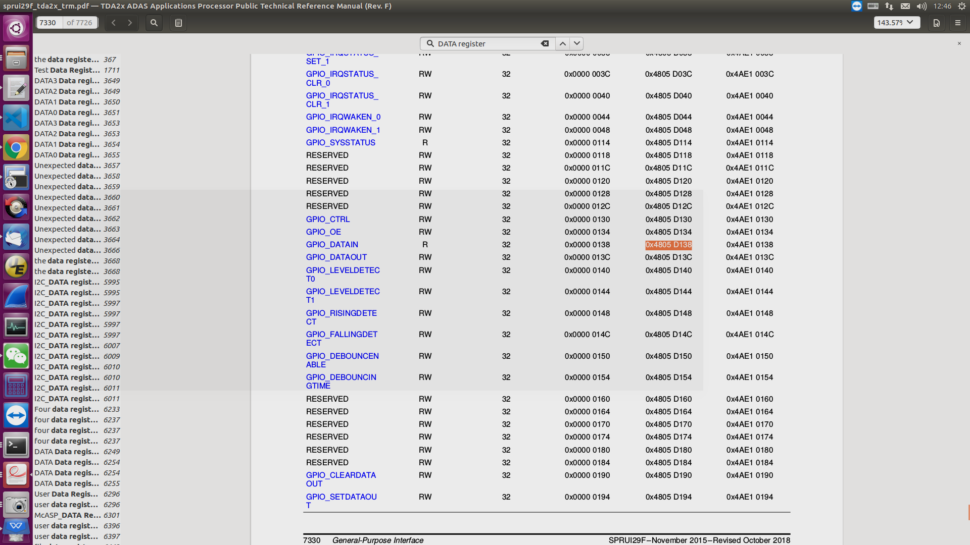

how could we get the status of the pin when kernel started?
