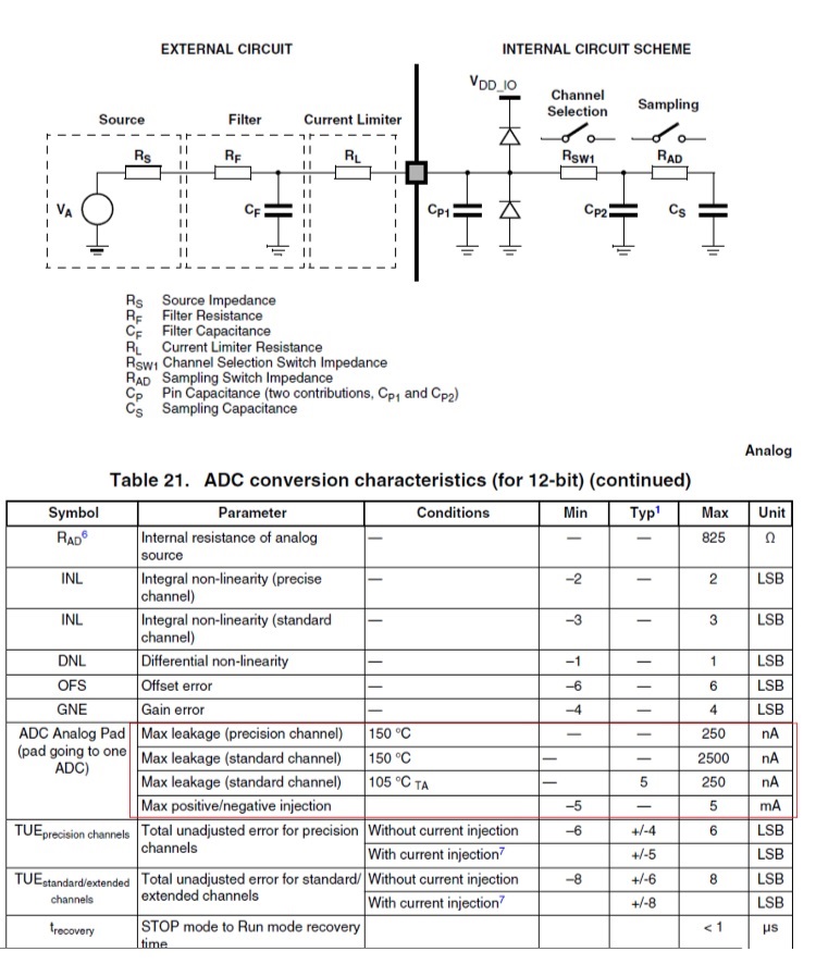

Hi TI Support Team
Can you please share the TDA4 ADC and GPIO block diagram with below info:
1. TDA4 ADC internal parameters include Clamping diodes forward voltage ; ADC injection current. ; leakage current; leakage resistance……
2. TDA4 GPIO internal parameters include Clamping diodes forward voltage ; PU Resistor ; PD Resistor; GPIO injection current. ……
