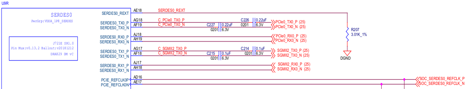

Hi, we are analyzing Ethernet capabilities on TDA4x with goal of using it for development of TDA4 SoC based platform.
We can see that TDA4VM EVM evaluation module have Quad Ethernet expansion board with integrated Quad-SGMII PHY and two Stacked RJ45 SGMII interfaces.
When we boot linux none of these interfaces can be found by kernel, unlike MCU RGMII interface which is named eth0 by kernel, see ifconfig result below:
eth0   Link encap:Ethernet  HWaddr F4:84:4C:F4:D7:FF
          UP BROADCAST MULTICAST  MTU:1500  Metric:1
          RX packets:0 errors:0 dropped:0 overruns:0 frame:0
          TX packets:0 errors:0 dropped:0 overruns:0 carrier:0
          collisions:0 txqueuelen:1000
          RX bytes:0 (0.0 B)  TX bytes:0 (0.0 B)
We cannot figure out why we cannot see these four interfaces on Quad Ethernet expansion board connected to MAIN domain via SERDES0?
And how can linux know of MCU RGMII interface when it is connected to the MCU domain and not MAIN domain?
Can you help us to better understand how to manage these interfaces from linux side?

    We are also curious why we must disable pcie0 on serdes0 in order for eth expansion board to work? We see both of them are connected to serdes0 but each on different lane, pcie0 on lane0 and sgmii2 (connected to eth phy on eth expansion board) on lane1. Should not both of them be able to work?
    Or the driving clock for serdes can cause issues, hence sgmii and pcie have different work clocks (125Mhz and 100MHz respectively)?
    Regards.

    The reason for disabling the PCIe is due to the shared SerDes initialization. While it is a 2-lane SerDes and 1L PCIe can operate concurrently with 1L QSGMII it is required to set up both lanes at the same time. So the exact initialization sequence and dependencies to set up for the two interfaces concurrently is still in work. For now it needs to be an either/or.
