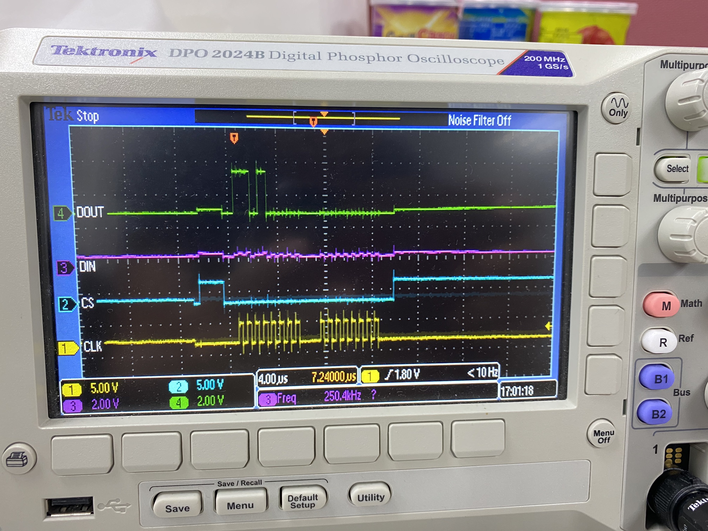

  • Hi Keerthy
    We have another problem is SPI bus error in SPL(MLO)
    although we can use sspi cmd without bus error, but the SPI bus is still error in SPL(MLO)

    SPI bus is fine under U-boot. Is there any difference when using SPI bus?
    Scott
  • Hi Scott,
    sspi as mentioned earlier is not validated.
    Can you check the device tree nodes for SPI and dependent ones have u-boot,dm-spl flag is set.
    Also DIN is not toggling so there might be issues with the slave side or DIN pinmux could be the issue.
    Since at kernel it is working can you just ensure that same configurations are done?
    Keerthy
  • Hi Keerthy
    We tried to add u-boot,dm-spl in \u-boot-2018.01\arch\arm\dts\am571x-idk.dts
    &mcspi2 {
    	status = "okay";
    	ti,pindir-d0-out-d1-in;
    	u-boot,dm-spl;
    	tsc2046@0 {
    		interrupt-parent = <&gpio1>;
    		interrupts = <25 0>; /* gpio1_25=25 */
    		pendown-gpio = <&gpio1 25 GPIO_ACTIVE_HIGH>;
    		reg = <0>; /* CS0 */
    		compatible = "ti,omap4-mcspi";
    		u-boot,dm-spl;
    		spi-max-frequency = <1500000>;
    		vcc-supply = <&ldousb_reg>;
    		ti,x-min = /bits/ 16 <0>;
    		ti,x-max = /bits/ 16 <8000>;
    		ti,y-min = /bits/ 16 <0>;
    		ti,y-max = /bits/ 16 <4800>;
    		ti,x-plate-ohms = /bits/ 16 <40>;
    		ti,pressure-max = /bits/ 16 <255>;
    		ti,swap-xy;
    		wakeup-source;
    => sspi 2:0.0 16 d0
    __of_translate_address: Bad cell count for tsc2046@0
    0000
    => sspi 2:0.0 16 d3
    0000
    In \u-boot-2018.01\board\ti\am57xx\mux_data.h we have
    	{SPI2_SCLK, (M0 | PIN_INPUT)},	/* spi2_sclk.spi2_sclk */                                       /* spi2_sclk.spi2_sclk */
    	{SPI2_D1, (M0 | PIN_INPUT | SLEWCONTROL)},	/* spi2_d1.spi2_d1 */                               /* spi2_d1.spi2_d1 */
    	{SPI2_D0, (M0 | PIN_INPUT | SLEWCONTROL)},	/* spi2_d0.spi2_d0 */                               /* spi2_d0.spi2_d0 */
    	{SPI2_CS0, (M0 | PIN_INPUT | SLEWCONTROL)},	/* spi2_cs0.spi2_cs0 */                             /* spi2_cs0.spi2_cs0 */
    and this is the only pinmux file we had modified and tsc2046 is working fine in Kernel dmesg
    [    1.843940] of_get_named_gpiod_flags: parsed 'pendown-gpio' property of node '/ocp/spi@4809a000/tsc2046@0[0]' - status (0)
    [    1.844400] ads7846 spi1.0: touchscreen, irq 167
    [    1.849509] input: ADS7846 Touchscreen as /devices/platform/44000000.ocp/4809a000.spi/spi_master/spi1/spi1.0/input/input0
    Scott
  • Scott Lin2 said:
     tsc2046@0 {
            u-boot,dm-spl;
    You are using ldousb_reg & gpio1 nodes in your node. Do they have u-boot,dm-spl set? If not please
    add the below lines:
    &ldousb_reg{
    u-boot,dm-spl
    &gpio1{
    u-boot,dm-spl
    Keerthy
  • Hi Keerthy
    	model = "TI AM5718 IDK";
    	compatible = "ti,am5718-idk", "ti,am5718", "ti,dra7";
    	memory@80000000 {
    		device_type = "memory";
    		reg = <0x0 0x80000000 0x0 0x40000000>;
    	aliases {
    		spi2 = &mcspi2;
    	ads7846reg: fixedregulator-ads7846-reg {
    		compatible = "regulator-fixed";
    		regulator-name = "ads7846-reg";
    		regulator-min-microvolt = <3300000>;
    		regulator-max-microvolt = <3300000>;
    		regulator-always-on;
    		regulator-boot-on;
    &mcspi2 {
    	status = "okay";
    	u-boot,dm-spl;
    	tsc2046@0 {
    		u-boot,dm-spl;
    		vcc-supply = <&ads7846reg>;
    		ti,swap-xy;
    		wakeup-source;
    &ads7846reg{
    	u-boot,dm-spl;
    &gpio1{
    	u-boot,dm-spl;
    the value from cmd "sspi 2:0.0 16 d0" is still 0000
    Scott
    Scott,
    Adding u-boot,dm-spl was for the SPL issue that you were mentioning: .
    As i have been mentioning the sspi is never supported/validated on SDK.
    Keerthy
  • Hi Keerthy
    In SPL(MLO), using spi bus is still error please see the following log
    U-Boot SPL 2018.01 (Nov 03 2020 - 12:04:35)
    DRA722-GP ES2.1
    Trying to boot from MMC1
    no pinctrl state for default mode
    Invalid bus 2 (err=-19)
    Error using spi_get_bus_and_cs
    load uboot from FAT fs...
    U-Boot 2018.01 (Nov 03 2020 - 12:04:35 +0800)
    CPU  : DRA722-GP ES2.1
    Model: TI AM5718 IDK FTK
    Board: AM571x IDK REV 0.1
    DRAM:  1 GiB
    MMC:   OMAP SD/MMC: 0, OMAP SD/MMC: 1
    *** Warning - bad CRC, using default environment
    GUID Partition Table Header signature is wrong: 0x0 != 0x5452415020494645
    part_get_info_efi: *** ERROR: Invalid GPT ***
    part_get_info_efi: *** ERROR: Invalid Backup GPT ***
    SCSI:  SATA link 0 timeout.
    AHCI 0001.0300 32 slots 1 ports 3 Gbps 0x1 impl SATA mode
    flags: 64bit ncq stag pm led clo only pmp pio slum part ccc apst
    scanning bus for devices...
    Found 0 device(s).
    Net:   RMII External clock is not supported
    Warning: ethernet@48484000 using MAC address from ROM
    eth0: ethernet@48484000
    Hit any key to stop autoboot:  0
    => sspi 2:0.0 16 d3
    0000
    Scott
  • Hi Scott,
    Can you share the code changes done for SPI enabling in SPL?
    Keerthy
  • Hi Keerthy
    Support SPI in both U-boot and SPL the only change we have done are DTB and cm_l4per_mcspi2_clkctrl
    In u-boot-2018.01\arch\arm\mach-omap2\omap5\hw_data.c we have
    void enable_basic_clocks(void)
    +       (*prcm)->cm_l4per_i2c2_clkctrl,
    +       (*prcm)->cm_l4per_mcspi2_clkctrl,
    void enable_basic_uboot_clocks(void)
    Scott
  • Hi Keerthy
    Could you help to reply?
    Scott
  • Hi Daniel,
    Apologies for the long silence. There is not much support for sspi in u-boot & even SPL side.
    The experts advice was to try on Linux. I believe that is already functional for you.
    Keerthy
