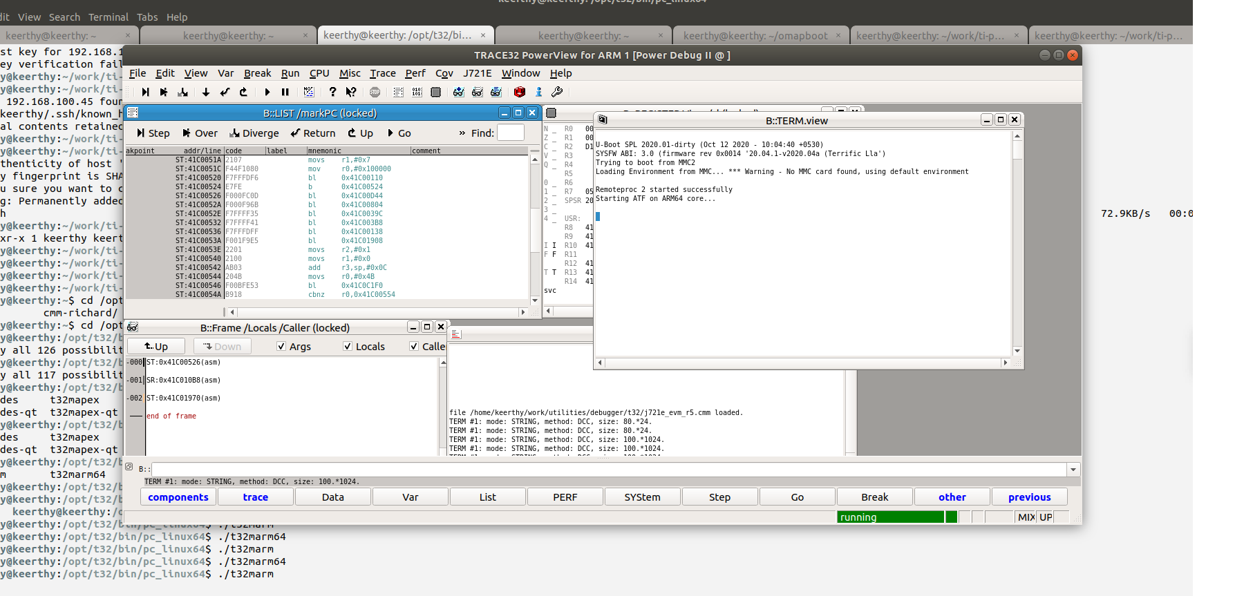

    Now Set PC to immediate next instruction. As example in the below screenshot the infinite loop is at 0x41c00524 so Set the PC to 0x41c00526
    to get out of while loop. Press run.
    One should see DCC window with R5 SPL booting:

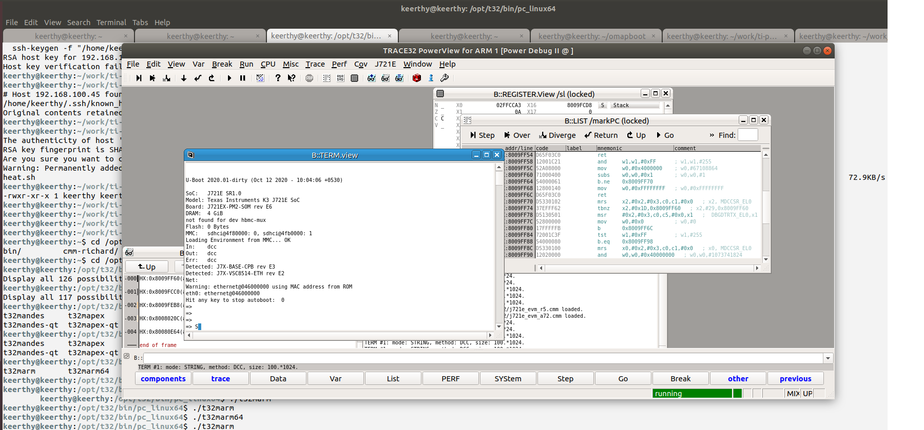

    Now we are done with R5 SPL now close t32 and open 64 bit mode using t32marm64 and run a72 cmm script: j721e_evm_a72.cmm
    Run commands mentioned above to open DCC window and then press run. You Should see a72 SPL & u-boot prints like below.
    Press enter to get to u-boot command prompt.
