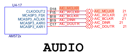

AM5728: TLV320AIC304 audio codec configuration
Part Number: AM5728
I have a AM5728 custom board.
I use ti-processor-sdk-linux-am57xx-evm-06.03.00.106-Linux-x86-Install.bin
I use am57xx-beagle-x15-common.dtsi,  I just  changed "assigned-clocks = <&l4per_clkctrl DRA7_MCASP3_CLKCTRL 24>"   to "assigned-clocks = <&l4per_clkctrl DRA7_MCASP3_CLKCTRL 22>;"

	sound0: sound0 {
		compatible = "simple-audio-card";
		simple-audio-card,name = "BeagleBoard-X15";
		simple-audio-card,widgets =
			"Line", "Line Out",
			"Line", "Line In";
		simple-audio-card,routing =
			"Line Out",	"LLOUT",
			"Line Out",	"RLOUT",
			"MIC2L",	"Line In",
			"MIC2R",	"Line In";
		simple-audio-card,format = "dsp_b";
		simple-audio-card,bitclock-master = <&sound0_master>;
		simple-audio-card,frame-master = <&sound0_master>;
		simple-audio-card,bitclock-inversion;
		simple-audio-card,cpu {
			sound-dai = <&mcasp3>;
		sound0_master: simple-audio-card,codec {
			sound-dai = <&tlv320aic3104>;
			clocks = <&clkout2_clk>;

	tlv320aic3104: tlv320aic3104@18 {
		#sound-dai-cells = <0>;
		compatible = "ti,tlv320aic3104";
		reg = <0x18>;
		assigned-clocks = <&clkoutmux2_clk_mux>;
		assigned-clock-parents = <&sys_clk2_dclk_div>;
		status = "okay";
		adc-settle-ms = <40>;
		AVDD-supply = <&vdd_3v3>;
		IOVDD-supply = <&vdd_3v3>;
		DRVDD-supply = <&vdd_3v3>;
		DVDD-supply = <&aic_dvdd>;

&mcasp3 {
	assigned-clock-parents = <&sys_clkin2>;
	status = "okay";
	op-mode = <0>;	/* MCASP_IIS_MODE */
	tdm-slots = <2>;

This is my kernel log
the  "assigned-clocks = <&l4per_clkctrl DRA7_MCASP3_CLKCTRL 24>" ,An error is reported after startup, unable to enter the system.
8272.DRA7_MCASP3_CLKCTRL 24_log.txt
the  "assigned-clocks = <&l4per_clkctrl DRA7_MCASP3_CLKCTRL 22>"

This is my schematic
DJ-AM57X-Audio (3).pdf
