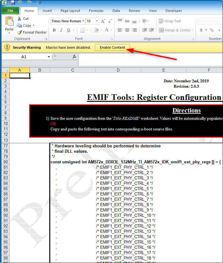

    const unsigned int AM572x_DDR3L_532MHz_TI_AM572x_IDK_emif1_ext_phy_regs [] = {
    , /* EMIF1_EXT_PHY_CTRL_1 */
    , /* EMIF1_EXT_PHY_CTRL_2 */
    , /* EMIF1_EXT_PHY_CTRL_3 */
    , /* EMIF1_EXT_PHY_CTRL_4 */
    , /* EMIF1_EXT_PHY_CTRL_5 */
    , /* EMIF1_EXT_PHY_CTRL_6 */
    , /* EMIF1_EXT_PHY_CTRL_7 */
    , /* EMIF1_EXT_PHY_CTRL_8 */
    , /* EMIF1_EXT_PHY_CTRL_9 */
    , /* EMIF1_EXT_PHY_CTRL_10 */
    , /* EMIF1_EXT_PHY_CTRL_11 */
    , /* EMIF1_EXT_PHY_CTRL_12 */
    , /* EMIF1_EXT_PHY_CTRL_13 */

  • user5947671 said:
    (2) And the ext_phy_regs  generate by emif tool is empty, I don't change in code either.
    You have to enable macros in Excel in order to compute these values.  Here's what that looks like for me:

    I enable the macros in excel and it have phy ext reg now.
    But when I replace the lisa map and the related emif_reg, ext_phy_reg generate by tool, the uboot totally don't work, don't print anthing.
