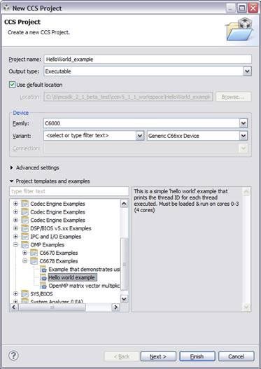

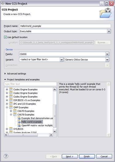

    1. Create a New Project based on the OpenMP helloworld template:
    • Open CCS (preferably with a new workspace).
    • Open File->New->CCS Project and in the project name field enter HelloWorld_example (or whatever name you desire for the project)
    • In the CCS project window, select Project Type as C6000
    • In the New CCS Project, select Device Variant: as Generic C66xx Device.
    • In the Project Templates window select “OMP Examples à C6678 Examples à Hello world example” and hit Next. See figure below.
    • Verify your RTSC settings. The following packages should be selected: BIOS, IPC, OMP, PDK, and MCSDK
    2. Next, build this project as-is. The project should build successfully. You might see a warning saying "warning #10247-D: creating output section ".TI.tls" without a SECTIONS specification." You can ignore this warning. Next load and run this project as-is to ensure that it runs as expected. You should see a hello world printed from each core.

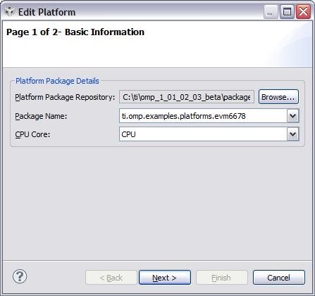

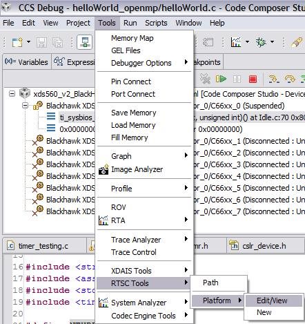

    3. Now let's get to your code, starting with input/output buffer allocation. If you use malloc to allocate your buffers, they will be allocated in DDR. You should be able to get better performance numbers if you place your input and output buffers in MSMC. You can follow the steps here to place your input buffers in MSMC. To understand this, first look at the platform file showing the memory map for this OpenMP example. To do this, go to CCS Debug View and view the RTSC Platform as shown in this snapshot below:
    Now click Browse and select the following directory "C:\ti\omp_1_01_02_03_beta\packages." Once you do this, you should see an option under "Package Name" called "ti.omp.examples.platforms.evm6678" as shown in the snapshot below:
    Once you click "Next" you will see the memory map as shown in the snapshot below:
    As you can see in the memory map above, there is a region called MSMCRAM_NOCACHE. Note that this region of MSMC is ~3MB in size. Some of this memory is used to store OpenMP runtime variables, etc. However these do not require much space, and since your input buffers require only 300KB x 2 = 600KB, you should be able to use this MSMCRAM_NOCACHE region to allocate your buffers. To do this, you will need to add the following in your .cfg file:
    Program.sectMap[".inputbuff"]  = "MSMCRAM_NOCACHE";
    In your helloWorld.c file you can place the buffer in this region as follows:
    #pragma DATA_SECTION(pBuffer_1, ".inputbuff");
    #pragma DATA_SECTION(pBuffer_2, ".inputbuff");
    #pragma DATA_ALIGN(pBuffer_1, 128);
    #pragma DATA_ALIGN(pBuffer_2, 128);
    char pBuffer_1[300*1024];
    char pBuffer_2[300*1024];
    You can use a simlar approach to add the output buffer in MSMC too, as long as it isn't too large.
