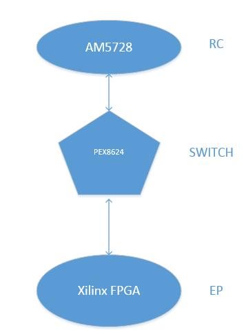

Hi ,our custom board based on AM5728 idk referenc.the topology of the pcie as follow figure
we load the ep program before  the system on am5728 boot up, we enter the commond lspci in the consol, the return information just have the the device am5728 and the PXEX8624,there's no infromation about the fpga.the result show as follow picture,

    Could you post the output of "lspci -v"? and is it possible to try connect the EP to the board directly without the swtich?
    Rex
  • Hi,Rex,because the design the EP must be connected by switch to RC,the lspci -v show as:

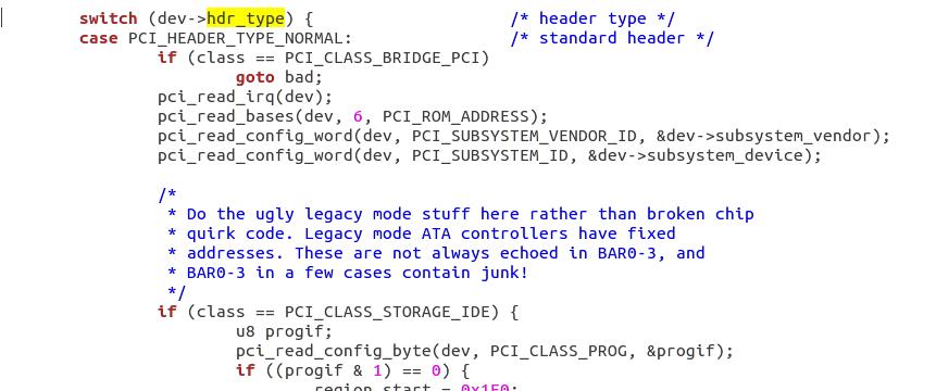

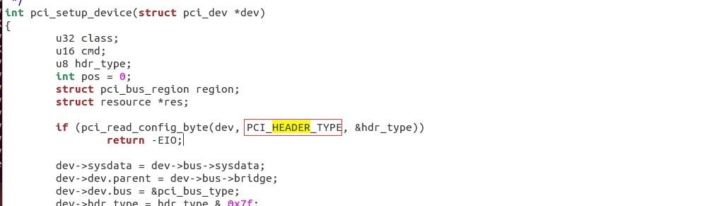

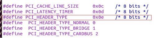

  • Hi,Rex,we connect the EP directly,the EP information can be find with the lspci -v,we referenced the link you send us,we have some doubts about the link,
    (1) "The PEX 8606 header type is read from PCI driver probe.c using byte access at 0xe and always gets back 0x00. Changing this to a 32 bit access at 0xc got the correct header type value of 0x01." does it mean modify the 0xe by 0xc.
    (2) "I've modified probe.c in the kernel (4.4.49) to handle this, but suspect there could be other problems due to non aligned access." we couldn't find the the place in the prob.c about (1) to modify.we find int the prob.c line 1187  with red box
    and line 1236 to deal with different hdr_type.,
     we seach the MACRO PCI_HEADER_TYPE are defined in the pci.h under board-support/u-boot-2016.05+gitAUTOINC+4db46a6bbd-g4db46a6bbd/include dir.
    we change the 0x0e to 0x0c ,but the ep cann't be recognized by the RC, did we understand the link wrong?

  • Hi,Rex,yes you are right ,"The way I understand is not only the read address need to be changed from 0x0e to 0x0c, but also the length. Instead of doing byte read, it needs to read a word (32 bits)." we modify the prob.c in the /home/ti-processor-sdk-linux-rt-am57xx-evm-03.03.00.04/board-support/linux-rt-4.4.41+gitAUTOINC+968d071ce9-g968d071ce9/drivers/pci ,the ep can be emunated now.
    int pci_setup_device(struct pci_dev *dev)
    u32 class;
    u16 cmd;
    //u8 hdr_type;
    u32 hdr_type;
    int pos = 0;
    struct pci_bus_region region;
    struct resource *res;
    //if (pci_read_config_byte(dev, PCI_HEADER_TYPE, &hdr_type))
    if (pci_read_config_dword(dev, 0xc, &hdr_type))
    return -EIO;
    hdr_type = hdr_type>>16;
