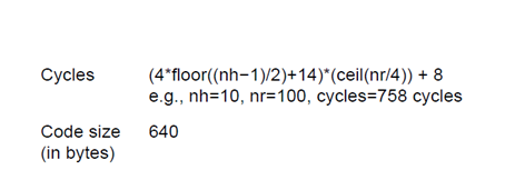

I am using OMAPl138 DSP evaluation board(LCDKOMAP138). As Timing is Processing time is the critical issue for my code, I am unable to check how to find the Processing time for Each C code or Functions in CCS. Please, help me to resolve this issue.
  •  And  Adding to the question as in the TMS320C67x DSP Library Programmer's Reference Guide (Rev. C) Documentation, for Each code as it was mentioned the number of clock cycles required for each function. How can I verify whether my timing/ Clock cycles I am able to meet or not? Please, find this below image for Reference from the document(spru657).

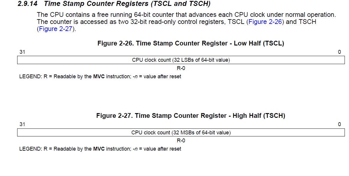

    There is a free running 64-bit counter, which you can use for counting cycles.
    You can refer to sprufe8 (rev b) document for CPU and Instruction set for C674x DSP.
    Note that to start counting you need to initialize TSCL to 0. You can initialize TSCL to 0, and then do the following:
    1. Initialize TSCL = 0
    2. Read TSC (lo) and TSC (hi) values (Start values)
    3. Call the function of interest for benchmark
    4. Read TSC (lo) and TSC (hi) values (End values)
    5. Compute the difference between End and Start to get the cycles. That should provide you the cycle information for the function under 3.

  • Hi Manikanta,
    The placement of code and data, enabling cache plays significant role in the cycles.
    By the way, You do not need to initialize TSCH. Please don't update TSCH out of power cycle. You can write TSCL=0 to start counting.
    1. Keep the Program and Data in the internal memory, if you have placed them in external memory
    2. Make sure you have Cache enabled.
    3. Verify the cycles info for the values that is shown in the data sheet of DSPLIB. with NH=10, NR=100, you should be getting cycles around 780 cycles. If not, you can single step the code and identify the instructions that is impacting this, to get the cycles formula for your settings.
    4. Once you figure out the cycles formula, for the code/data placement and cache settings for your case, you can verify it for other inputs like you provided.
