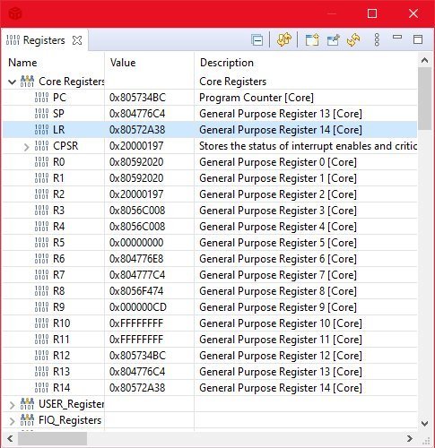

The console registers display as
 100
However the debugger registers are different:
Any one have ANY clue?  And can explain this to me?

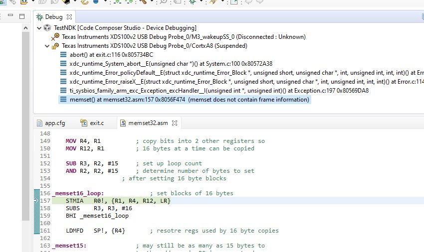

    Can you please make sure it is the memset which causes the crash? Also, if this is repeatable crash, you can check if the memory it is accessing and if the ARM has permissions to access those memory areas.
    Please let me know.
  • Aravind,
    My screen shot show shows the crash. You can see at the bottom of the stack trace it's "memset".
    When the debugger is launched, it is supposed to set a break point at "main()" which means all the C initialization has occurred. This is happening without ever reaching that breakpoint.  I see no way to place a breakpoint BEFORE main() when it SYSBIOS because it does everything under the covers and behind my back.
    Also, if the MMU has not been set up to allow permissions to this memory, that again is something that is done under the covers and behind my back.  This project actually has a call to setup the MMU, but (obviously) that occurs once main() is entered.  And execution never gets there.
    It reliably does this.  it didn't used to.  I changed the heap and stack size, and it started and won't stop.  Even when I return them to the previous settings, it continues to crash.
    I really hate the way this does this kind of crap behind my back, altering other settings that I have no control over and need a PhD to figure out what is going on down in the bowels.

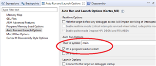

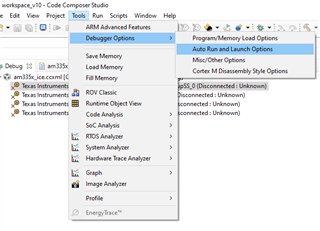

  • Hi Christopher,
    You can disable goto main option under CCS to single step. This allows you to step through everything pre-main.
    Uncheck "On a program load or restart" to prevent it to run to main, so that you can single step premain programs.
  • Well, none of this works.  But that doesn't surprise me in my dealings with this horrid environment.

    Now I step through "boot.asm" which is from the SYSBIOS source folder.
     At line 356 is BL's (branch on link register) to __TI_auto_init...
    In auto_init.asm  it enters the _b1_loop_ at line 364 and on the third loop it calls BLX r4. (whatever the third entry is in the "cinit" table...  no doc, I have no idea.)
    And that is into "copy_zero_init.c"   And the stack traces shows it is in memset  (why did you not believe me??)
    At this point, R0 is 0x80000000 (as expected), and R2 is 4D6C9E (which matches the map file .bss segment size).  It crashes when calling BX LR in an attempt to return  ( LR = 0x8056EEA8)
    Which, according to my map file, is in the .text segment.

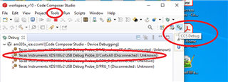

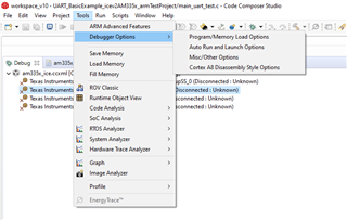

  • Hi Christopher,
    I see you are going through many issues.
    There is NO tools menu in the CCS window when editing.
    The tools menu doesn't have that option in the debug perspective.
    - Can you let me know your CCS version? Note that you need to select the core you are debugging to get to this menu. Also, make sure you are on CCS debug view.
    Example: Here I selected the Cortex A8 core under CCS Debug:
    After that when you click on Tools, you would get this menu option.
    It acted EXACTLY as it did when I press "Debug"...  Loads the program immediately and tries to run to the break point.  Of course it crashes.
    NO OPTION to tell it not to do that.  (What crap this is...)
    - The option that I provided to disable the run to main(), would make the program just load and it would wait for you to either run or single step to reach to main().
    Let me know if you still have issues to disable the PC run to main(). Please provide your CCS version details etc so that I can match exact versions and possibly guide on getting the disable "run to main()" option for you.
    PS. The CCS version that I used for this snapshot pictures is: (Via Help-> About Code Composer Studio:

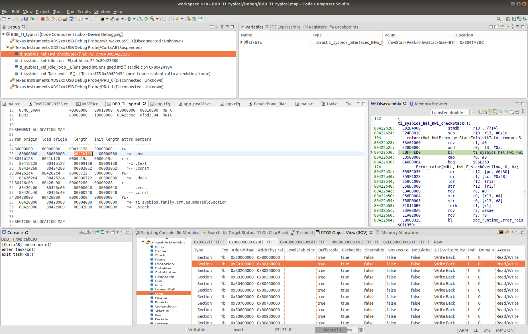

  • I have no idea if that has anything to do with it crashing on memset, or if that is the reason.
    From the console exception dump:
    DFSR = 0x00000805. Decoding as per Data Fault Status Register :
    • RW = 1 = write access caused the abort.
    • Status = b000101 translation fault, section
    Memory access sequence says:
    If translation table walks are disabled, the processor returns a Section Translation fault.
    This means the MMU has generated a translation fault. FSAR = 0x80100000 is the address at which the fault occurred which is an offset of 1Mbyte from the start of DDR3.
    From the map fragment address 0x80100000 is within the .bss section, so at start up the run time library initialisation code will be zeroing the .bss section.
    So, it looks like something has gone wrong with the MMU configuration in the project.
    In CCS 10.2 I just imported a project using the SYS/BIOS "typical" example for a BBB using the same XDC 3.32.2.25, SYSBIOS 6.46.5.55 as you are using, and the only change I made was in the .cfg file to set the same heap size as you are using:
     * The BIOS module will create the default heap for the system.
     * Specify the size of this default heap.
    BIOS.heapSize = 4292608;
    And the segment allocation map is similar to yours in that the .bss section starts at 0x80000000 with length 0x0041b128. The example initialises and runs OK.
    In CCS "MMU On" is reported in the target status as the bottom left, and using the MMU view the RTOS Object View (ROV) shows the MMU has been configured to set the DDR region as Cachable with Read/Write access.
    The default of SYS/BIOS is to configure the MMU to give cachable read/write access to all of the memory regions defined in the platform. From memory, the only manual step normally required to the MMU configuration is to enable mappings for some peripherals, but that is not your problem.
    I have attached my example.
    I'm not sure what has gone wrong with your program. Are your able to zip up and attach your project, to aid looking at what causes the apparent MMU configuration issue?
    BBB_TI_typical.zip

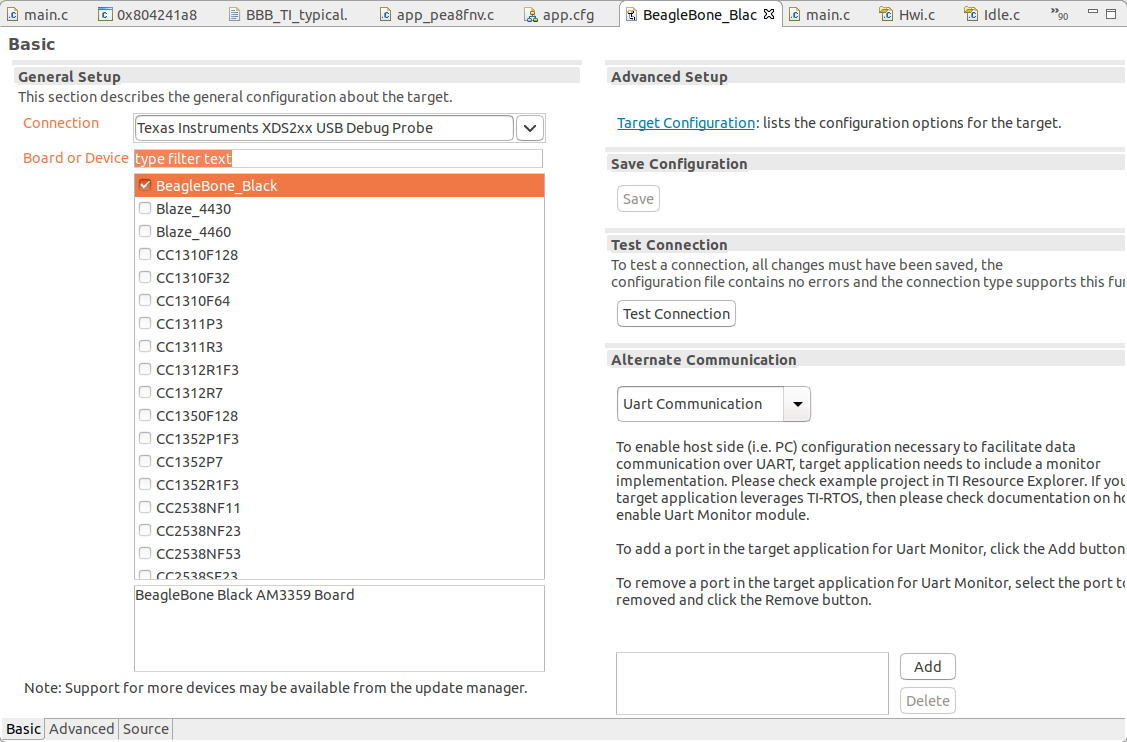

  • Next up... I need to HACK the gwad awful, undocumented, incomprehensible "ccxml" files.
    Since you are using a BBB, in the target configuration file you should just be able to select the debug probe as the Connection, and then enter BeagleBone_Black as the Board or Device to use a usable setup:
    Which should set the initialisation script for the CortxA8 to ../../emulation/boards/beaglebone/gel/beagleboneblack.gel
    The GEL file for the initialisation script is important to configure the BBB to allow a program to be run.
    Which initialisation script are you using?
    If I take my working target configuration file and change the Board or Device from "BeagleBone_Black" to "AM3358" the initialisation script for the the CortxA8 is blanked and the program then crashes before main is reached. E.g. got the following exception which has the same DFSR register value as your crash, albeit the DFAR value is different:

    I tried changing the CCXML "board or device" to BBB, as somehow it was changed to just a AM3358.  It didn't make any difference, my MAP file still showed that is has 1 gig.
    Until I come back and retry this weekend after comfortably attempting to forget all the trouble this is giving me.
    This morning it works.
    I am marking this as resolved, except I don't know why. It appears to have resolved itself after deciding that when I changed the "board or device" from the correct MCU to the correct board... I really meant it.  Or decided that it needed a reboot.  Or decided that daylight savings time would solve it.

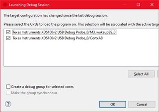

    Except now when I started a DIFFERENT unit test program, it's asking me which core.   For TWO WEEKS I was using this test program, and it (as usual) only asked me one time when I created it.  Now it decided to forget.

    Glad to see you finally got this resolved. I do not know, if you had searched ARM TRM for DFSR register. The register is from ARM and hence you would not see details/documentation on DFSR on AM335x TRM. For all ARM cores, please refer to ARM documentation.
    I've never seen anything defining the DFSR register.  It's not in the ARM books I've got, but those are mostly "M" cores.  Of course attempting any kind of a search in the TI world gets me nothing.
    I got below from ARM DFSR register: https://developer.arm.com/documentation/ddi0344/k/debug/debug-exception/effect-of-debug-exceptions-on-cp15-registers-and-wfar
    Also, regarding below:

    I was noticing you had issues on how to prevent application to reach main() after CCS load etc and provided details/inputs on that.
    https://e2e.ti.com/support/processors/f/processors-forum/985638/processor-sdk-am335x-ccs-question
    Half the time they effect how a "project" reacts when I press "debug," half the time I have to right click and pick Debug As | Debug configurations...  and then they all mix into a soup where all the CCXML file randomly apply to any project.
    - Thanks for providing the feedback on CCS. Someone from CCS team would respond to your questions in above thread.

    I am 100% confident it was an access violation during memset()
    I am 100% confident it was occurring prior to main() being called
    I am 100% confident it has something to do with what MCU it thought it was talking to
    I am 0% understanding why CCS decided to change the MCU type in the properties or the CCXML on a project I've been using for months.
    I am 0% understanding why changing it back didn't have any affect until I returned after the weekend.
