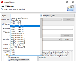

    So, just for fun. lets try yet another "Out of the Box" failure courtesy of this environment.
    Rather than use a BeagleBone as my unit test device, let's pretend I have a different device using an AM3358.
    The goal is to tell the build system how much memory the device has.
    I create a project, setting it to use a AM3358  (which is a BeagleBone anyway)
    Next, I try to set the "platform".  But naturally, it's empty, because the environment is always got defects...
    By manually setting up a "repository" (whatever that means in this context) from preinstalled platforms... there is no AM3358.  The closest is AM3359.  So I pick that.
    The wizard creates a projects...  I press build and...
    Naturally, right out of the box, it fails.
    No rule to make .configro  ?  Something I've never heard of.
    No rule to make files that are in configPkg...  a folder that doesn't exist in the project.
    So... before I can even get to the point where I want to ask the question "Where do I set...?"  I've been dragged two steps backward because of this environment that is crap.  And no idea what the heck is going on.
  • Hi Christopher,
    I see that CCS is broken in providing you some dropdown options for the project creation.
    However, you should in future provide details on the component versions and PDK version that you are using along with any out of box PDK examples (if any) that you are using. Even if you are trying to build your own projects, providing the PDK version is helpful in identifying the components.
    Example, In this thread, it is hard for me to figure out those details. Based based on pictures that you posted, I guess the PDK version that you are using, based on the info (sys bios and xdc version) - It appears to me that you are using PDK 6.3 release.
    Now back to the question that you had on the CCS project that fails via the template:
    I see you kept the  Target as empty in the new CCS project create wizard - Can you provide inputs on why you did not pick up AM335x - Cortex A8 target with BeagleBone_Black, if you are looking for memory details for that board as below?
    I will request the CCS team to look into this issue further - someone from that team would be responding to this CCS issue.
    I can't explain the meaning of the exact error messages, but I can explain the root cause of the issue. Basically, A8F support was dropped in BIOS 6.75 and later. I see that you are using BIOS 6.76. You will need to go with an earlier BIOS version. I tried it with 6.73 and that worked fine. See ToodMullanix's post in the below thread: https://e2e.ti.com/support/processors/f/processors-forum/887584/sysbios-am335x-xdc-tools-build-error/3283197#3283197
