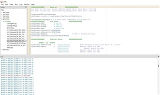

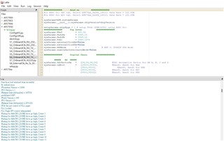

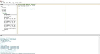

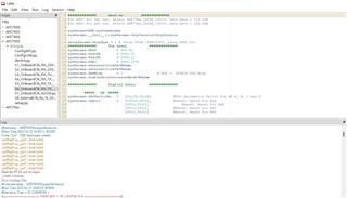

  • Hi David,
    Thanks for help !
    I follow your suggestion splitting the programming of the AFE and LMK
    It seems that LMK can output the correct channel so that the ADC can get the right REFCLK.
    However I encounter the next problem:
    the machine seems not to get MACRO_DOWN bit to go high
    Here is the screenshot for latte program:
    step1: setup.py
    step2: devinit.py
    step3: ConfigLMK.py
    and then I use the LMK Clock Divider setting the correct LMK output ( Checked by oscilloscope )
    step4: ConfigAFE.py
    It turns out to be the loop of wait for MACRO_DOWN bit to go high..........
    Please help, thanks

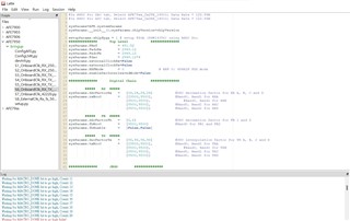

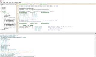

  • Hi Naiwen,
    This error may still be because of the clock. Can you confirm that the AFE is receiving the correct frequency for its RefClk, 491.52MHz? Also, can you share the LMK settings that you are using for the AFE reference clock output.

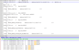

  • Hi David,
    Following attachment is log generated by latte and labview.
    In the labview log, the 1st error correspond to the OPCODE=0x1 and the 2nd error correspond to the OPCODE=0X78.
    In what circumstance will it cause the OPCODE=0x1 and OPCODE=0X78 ?
    Where can I find the document about these OPCODE ?
    Thanks~
    Afe79xxPg1_0217.txtLabview log.txt

  • Hi Naiwen,
    You can still use this script but you will receive the DAC JESD errors after the AFE configuration. To fix this you can disable the DACs by adding the following line, sysParams.txEnable = [False,False,False,False], before the AFE.deviceBringup() command.
    The opcodes correspond to a certain Macro command that will be executed internally. Once the macro has completed a bit will be set to '1' indicating you can move on to the next step in the programming sequence. The issue that you are having is that when you are polling the macro done bit it never gets set to '1', which indicates that there is some error. Information on the opcodes and macros can be found in the Register Set document, SBAU337, which is available in the AFE79xx secure folder.
    One thing that can be tried on the AFE ref clock is to change the output format to LCPECL. This will make sure that the reference clock has a enough swing for the AFE input.
    David Chaparro.
  • It seems that the error OPCODE is caused by RX data from FPGA~
    After closing the DACs, the latte software can run successfully.
    Thanks !
