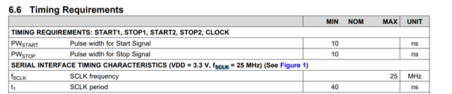

I checked the TDC7201 datasheet but don't found any information about TDC7201 SPI speed.
Would you let me know the Max speed of TDC7201 SPI ?

The spec fan be found in the data sheet under section 6.6. I have attached a screenshot of the datasheet below. But the max frequency of SCLK is 25MHz.
Additionally, you might find this thread interesting on the ability to make 1000 measurements in 1 second: https://e2e.ti.com/support/sensors-group/sensors/f/sensors-forum/604141/tdc7201-estimate-for-measurement-5000-times-per-second
