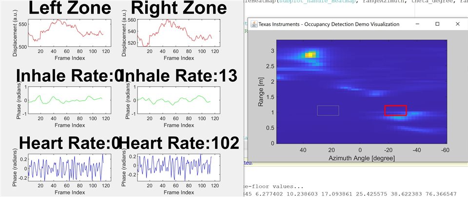

1- Why there is no noticeable change in phase of Inhale and Breathing in Occupancy and Vital Signs
2- AWR1843BOOST: Occupancy Detection and Vital Signs: Repeated Question
I need to what is Displacement phase of Heart rate - breathing rate?
What's the unit of Displacement?
if my question is wrong please correct me
Automotive toolbox version 3-2-0
Mostafa

     Please help us understand  which of the two is the appropriate question:
    1.A ) the demo doesn't work  -->  No difference in  heart rate/breathing rate  between occupied vs unoccupied vehicle/detection position.
    or
    1.B) Demo is unable to detect the difference  in heart rate  vs breathing rate  when position is occupied by person.

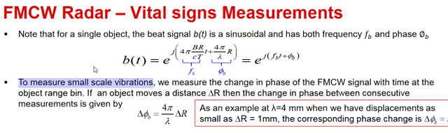

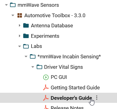

    We have provided/referenced development documents from the Tirex/labs which show the details of implementation and how the  detection rates are related to displacement.
    Relevant Section:
    Reference :  Slide #4
      For #2
