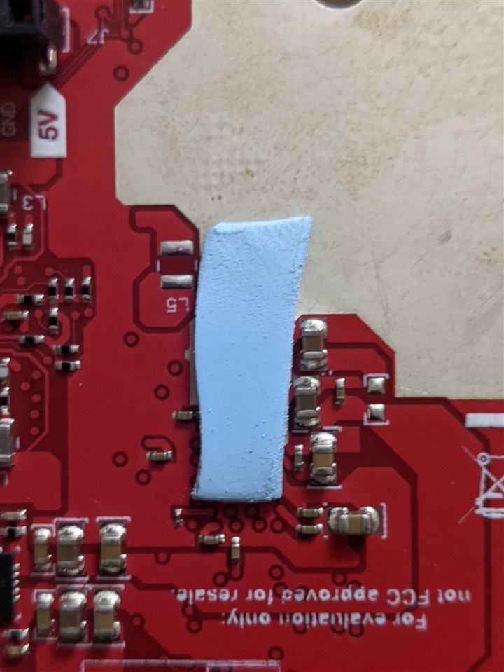

Please find the attached image, Can you please let me know, if the heat sink is fixed in the right way on AWR1642BOOST EVM.

Hi Vivek,
Good Day!
Thanks for correcting me, Since I thought the one I sticked is the heat sink & now I understand heat sink is made of aluminium alloy.
Can you please let me know, if I can place the heat sink on top of the thermal paste?, Do I need to cut the heat sink??
Guru
Hello Guru,
Yes, typically the heat sink is attached above the thermal paste. You need to make sure the heat sink does not contact any components on the board , like capacitors etc.
Vivek
Hi Vivek,
Thanks for the response. I will take necessary precautions.
This resolved my issue.

Please find the attached images of AWR1642 with heatsink, Can you please let me know, if the heat sink is placed correctly.
Guru
Hello Guru,
I looks good. You just need to ensure the thermal paste and heat sink do not touch or risk touching any of the capacitors around.
