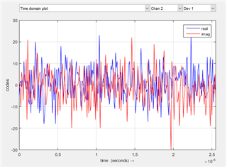

  • Hello Ishita,
    in order to extend observation time of signal I have set (in mmWave Studio) "Frame>No of Frames" to 0.
    Here is result after PostProc:
    I have attatched only one image, because rest of the captured frames were similar to the uploaded one.
    Tetris
  • Hello Tetris,
    Thankyou for the snippet.
    The sequence of steps in your previous reply looks good and should technically work. But because there is a problem, we might have to take a deeper look at all your configuration settings.
    Are you able to individually capture data using only one device? i.e. AWR1843 or AWR2243 alone?
    Also, what is the physical setup of both the devices and how are they oriented w.r.t each other?
    Ishita
