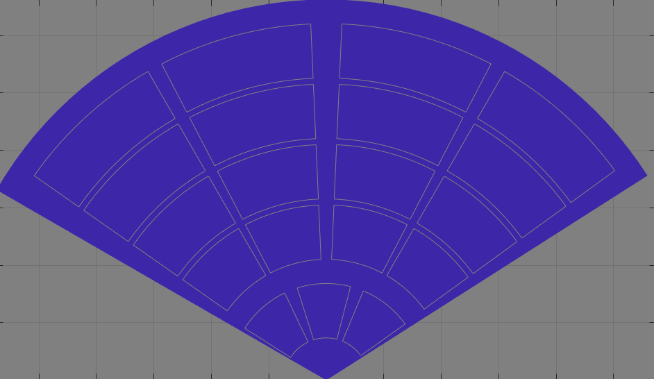

I am working on occupancy detection demo in Automotive toolbox.
https://dev.ti.com/tirex/explore/node?node=ANjPbaVnjUyzRAuPlBpY0g__AocYeEd__LATEST
Please I need the steps of how to change number of zones from the firmware.
I don't need any recommendations for other examples.
My steps was:
1- zoneDef 10  7 10 1 14  7 10 33 14  20 10 2 11  20 10 13 11  20 10 25 11  20 10 36 11   47 10 2 11  47 10 13 11  9 10 8 32  24 10 8 32
2- add  2 columns for each coeffMatrixRow
3- add 2 columns for each rowNoise
4- change ODDEMO_MAX_ZONES to 10
5- change ODDEMO_MATRIX_ROW_SIZE to 6
Is that correct?
